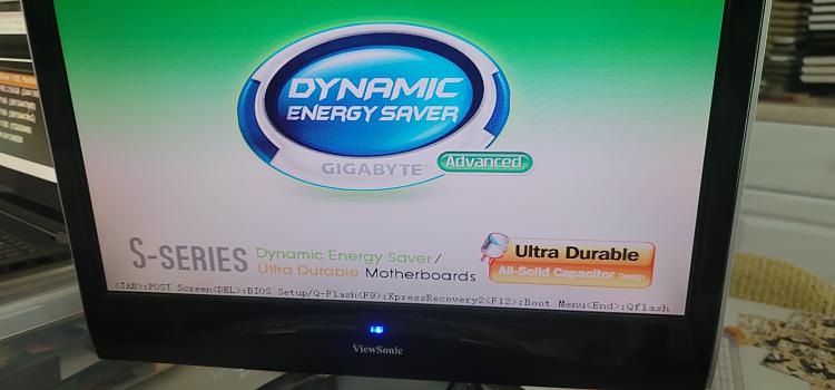

    1. At initial boot, and I select F12:
    Product id related information. 342497d1628105537t-reload-windows-10-pro-need-product-id-no-record-20210804_152129.jpg

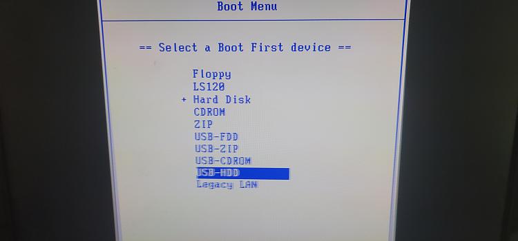

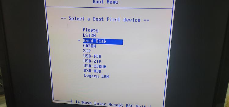

    2. This is the boot up screen after selecting F12. From this screen if I select Hard Disk:
    Product id related information. 342498d1628106091t-reload-windows-10-pro-need-product-id-no-record-20210804_152222.jpg

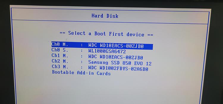

    It then presents with this screen listing the drives to select from:
    Product id related information. 342499d1628106209t-reload-windows-10-pro-need-product-id-no-record-20210804_152148.jpg
    The drive with the Windows files created with the tool is not listed. NOTE again...if I boot up my laptop that I'm on now, the drive is listed, I can select it, and it boots into Windows ready for me to install. So, for whatever reason, this older PC is not seeing the install drive. The drive I'm using is an 2.5" SDD drive mounted in a case for it and a USB cable.
    If I select USB-HDD as seen below:
    Product id related information. 342500d1628106390t-reload-windows-10-pro-need-product-id-no-record-20210804_152236.jpg

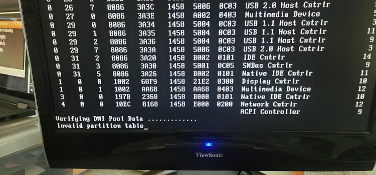

    I get the Invalid Partition error:
    Product id related information. 342501d1628106443t-reload-windows-10-pro-need-product-id-no-record-20210804_152244.jpg
