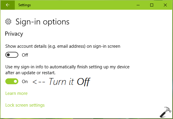

    So for some reason, recently my laptop started prompting for my password twice. I use fingerprint reader, and the first time it works. But when it prompts for login a second time, my account acts like fingerprint isn't assigned, I must enter password or PIN.
    However, if I select the second user account on this laptop Lenovo X280, it then accepts the fingerprint at the second prompt, even though that account does NOT have fingerprints setup at all!
    I have deleted all fingerprints in Windows and in BIOS. I have even deleted the second user account and made a new one. The same thing still happens. It's very strange.
    I have tried this fix too, but it didn't work.
