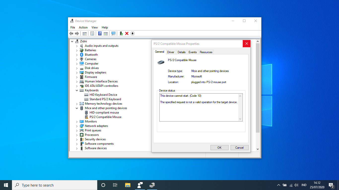

  1. PS / 2 compatible mouse ERROR code 10 Touchpad doesn't work
    steps already taken:
    + Driver Update ​
    + Uninstall the driver then reinstall​
    + Troubleshoot, error code 10 detected, but can't be fixed automatically​
    + Registry check:​
    HKEY_LOCAL_MACHINE \ System \ CurrentControlSet \ Control \ Class \ {4D36E96F-E325-11CE-BFC1-08002BE10318}​
    Value Type: Multi String​
    Value Name: UpperFilters​
    Value: mouclass​
    RESULTS: The four steps above have been carried out but ERROR CODE 10 still appears accompanied by an exclamation mark next to the PS / 2 COMPATIBLE MOUSE icon​
    TYPE OF WINDOWS: WINDOWS 10 VERSION 2004​
    TYPE OF LAPTOP: ACER ASPIRE 3 A315-41​
    PS / 2 compatible mouse ERROR code 10 Touchpad doesn't work 3e176dfb-a67c-44b5-b1f6-5d98857e67e2?upload=true.png ​
    Helen.diana, Jul 25, 2020
  2. touchpad doesn't work
    As you are unable to access touchpad after upgrade to Windows 10, this issue might be due to the outdated touchpad drivers on Windows 10.
    I suggest you to use the external mouse and check if it is working and try the below.
    Step 1:
    • Press Windows + X keys from the keyboard and click on
      Control Panel.
    • Click on Mouse.
    • On the Device Settings tab of the
      Mouse Properties screen, check the Disable button to turn off the Touchpad.
    • Restart the system and later enable it and check it you are able to access touchpad.
    Step 2: Update the synaptic drivers
    Steps:
    • Right click on Windows key from the desktop and click on
      Device Manager.
    • Expand Mice and other pointing devices, right click on the
      Touch screen driver (Synaptic driver) and select Update Driver Software.
    Also, I suggest you to contact the manufacturer's website and install all the drivers on your device.
    You can install Windows 8/8.1 drivers in compatibility mode if there are no Windows 10 compatible drivers.
    Follow the steps to install in Compatibility mode:
    • Download the updated driver from the manufacturer’s website.
    • Right click the driver installation file and select
      Properties then tap or click the Compatibility tab.
    • Place a check in the Run this program in compatibility mode for: box.
    • Tap the drop down box and select a previous operating system, then tap or click
      OK.
    • Try installing the driver and check.
    Hope it helps. Kindly let us know if you need further assistance with Windows Operating System. We will be glad to assist you.
    Deepika Gowda, Jul 25, 2020
