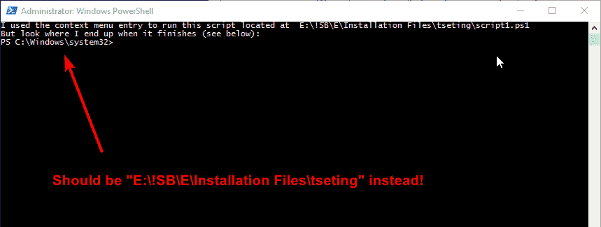

    I'm really close on this one. Basically, I want to create a context menu entry for .ps1 files that run the script as administrator without exiting the console window after running. So I can create the key:
    Code: Computer\HKEY_CURRENT_USER\SOFTWARE\Classes\SystemFileAssociations\.ps1\shell\RunasAdministratorNoExit[/quote] with the values:
    PS Context Menu Entry to Run Script as Administrator Without Exiting UkeWJ.png
    and that's all fine and dandy to create the entry. However, in order to actually make it do something, I need to add another key, the command key:
    Code: Computer\HKEY_CURRENT_USER\SOFTWARE\Classes\SystemFileAssociations\.ps1\shell\RunasAdministratorNoExit\command[/quote] And in this key, I have something that almost works, but not quite. So the default value of the above command key is:
    Code: Powershell.exe -WindowStyle Hidden -Command "& {Start-Process PowerShell.exe -Verb RunAs -ArgumentList '-NoLogo -NoExit -File """%1"""'}"[/quote] But there's one big problem with this method; when the script finishes, it returns me to the "C:\Windows\system32" directory instead of the directory of the script itself. See my image below for clarification:
    PS Context Menu Entry to Run Script as Administrator Without Exiting LX42k.png
    Further, when I use the context menu entry I created to run scripts containing lines such as:
    Code: $settingsfiles = Get-ChildItem -Recurse $scanPath[/quote] Instead of it recursing through all the folders local to the script I just ran, it tries to recurse through all the folders at "C:\Windows\system32!" Clearly this is undesired. So here's my question:
    What do I need to change in the default value of the command key in order to get the PowerShell script to act as if it was run from the same directory as the script?

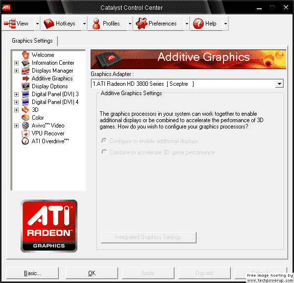

    I was recently greeted to a new entry in my desktop context menu after installing 8.12 drivers with the Catalyst Control Center:
    PS Context Menu Entry to Run Script as Administrator Without Exiting ati2.png
    I have no idea what the second entry does, since clicking it results in nothing happening.
    So I open up CCC and find this new section:
    PS Context Menu Entry to Run Script as Administrator Without Exiting ati1.png
    It's completely disabled. I only have a single HD3850. The IGP on my mobo is nVidia, which is disabled anyway.
    I spent the last hour or so finding a way to remove the second entry, and this is the only thing I could find:
    Deleting this key removes both entries from the context menu
    Code: KEY_CLASSES_ROOT\Directory\Background\shellex\ContextMenuHandlers\ACE[/quote] This solved one problem and caused another. I do not like the tray icon, so I have it disabled, so the only way I know to get into CCC is via the context menu. Does anyone know of a way to disable just the "Configure Additive Graphics" entry and keep the CCC entry?
    If I kept both disabled, is there some sort of shortcut I could make to get there instead? I don't want to have to go to Display->Settings->Advanced->CCC every time.
