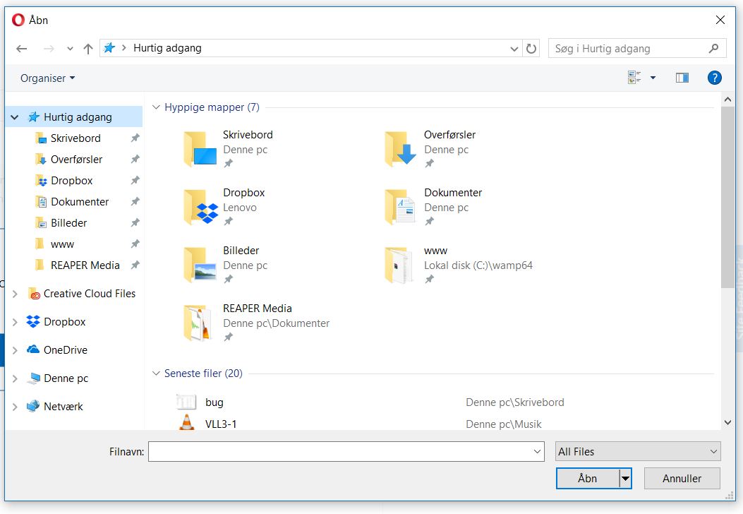

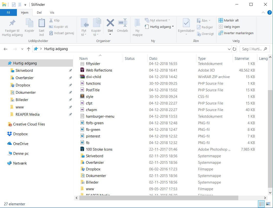

    Hi
    After yesterdays (04-12-2018) windows update my quick access looks wrong. It functions the same, but it doesn't sort the files and folder like it used to...(img1)
    When uploading image here i noticed that it worked as normal in the upload filebrowser.. (img2)...
    How do i fix this, please?
    Quick access bugged after December 2018 update 77f9bb6e-6895-41d9-9b59-18173f6f44ed?upload=true.jpg
    Quick access bugged after December 2018 update ce78d8c9-ced7-451e-b2cd-05c928cfee62?upload=true.jpg
    AndreasSchmidt Nielsen, Dec 5, 2018

  4. Quick access bugged after December 2018 update
    Quick Access Not Working
    Hi Dustin,
    Follow the below steps to repair the broken database of Quick Access.
    Method 1:
    Before repairing the database, try to disable and then re-enable Quick Access to see if it helps. To disable and re-enable Quick Access, follow the below steps:
    Step 1: To remove frequent folders and recent files list from Quick Access, open File Explorer > click on View tab in Ribbon >
    click on Options > Change folder and search options to open Folder Options.
    Step 2: You’ll have to uncheck the following two check-boxes present under the Privacy section to disable Quick Access:
    • Show recently used files in Quick Access.
    • Show frequently used folders in Quick Access.
    Step 3: Click Apply and Exit. The action will instantly remove these two sections from Quick Access in File Explorer. (To clear your Quick Access history press the ‘Clear’ button against Clear File Explorer History).
    Step 4: Then, check
    the following two check-boxes again to enable Quick Access that you did in
    Step2.
    Step 5: Restart the PC once and check the issue and if the issue persist, follow the
    Method 2.
    Method 2:
    The Method 2 will repair the broken database of Quick Access.
    Step 1: Open File Explorer and paste this folder path: %AppData%\Microsoft\Windows\Recent\AutomaticDestinations in the address bar and hit Enter.
    Step 2: Once the folder is opened, press ‘Ctrl’ key and the ‘A’ from your keyboard to select all of its contents and delete it.
    Step 3: Do the same for this folder path as well: %AppData%\Microsoft\Windows\Recent\CustomDestinations
    Step 4: Restart the PC once and check the issue.
    Hope it helps.
    Shafeeq Ali Khan
    Shafeeq_Khan, Dec 5, 2018
