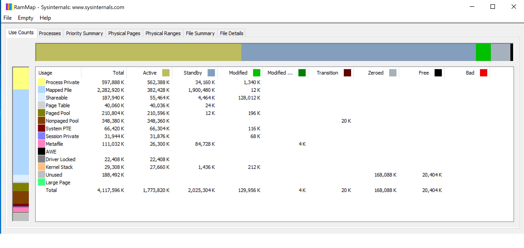

  4. Fortitude Win User
    RAM memory idling higher than normal
    Memory use shoots up to 99% after idle time
    I'm facing this problem in the last few days. Memory use according to Task Manager goes up to 99%, CPU reaches 80% and the PC becomes almost totally unresponsive.
    Based on similar threads I installed RAMMap and here's what is shown.
    RAM memory idling higher than normal [​IMG]
    I installed Poolmon and ran it and this is what I get.
    Please note that the first entry does not show a tag. Is this normal?
    According to the rest of the listing I should investigate Volsnap.sys and atc.sys. Could you advise what are the next steps?
    Fortitude, Nov 19, 2019
