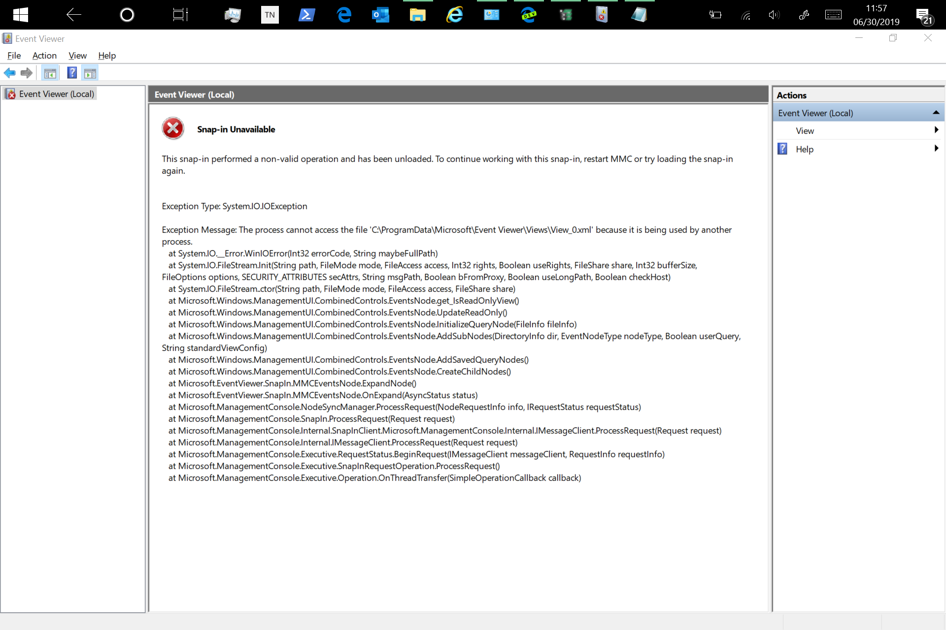

    3. And most recently, Event Viewer is throwing errors. It opens, loads, and the summary screen displays just fine. If I try to click to open something, I get a pop-up about a snap-in error. If I elect to unload the snap-in (alternative being 'report error and close') none of the other views will load (image below), and usually another error is thrown (stack trace included below).

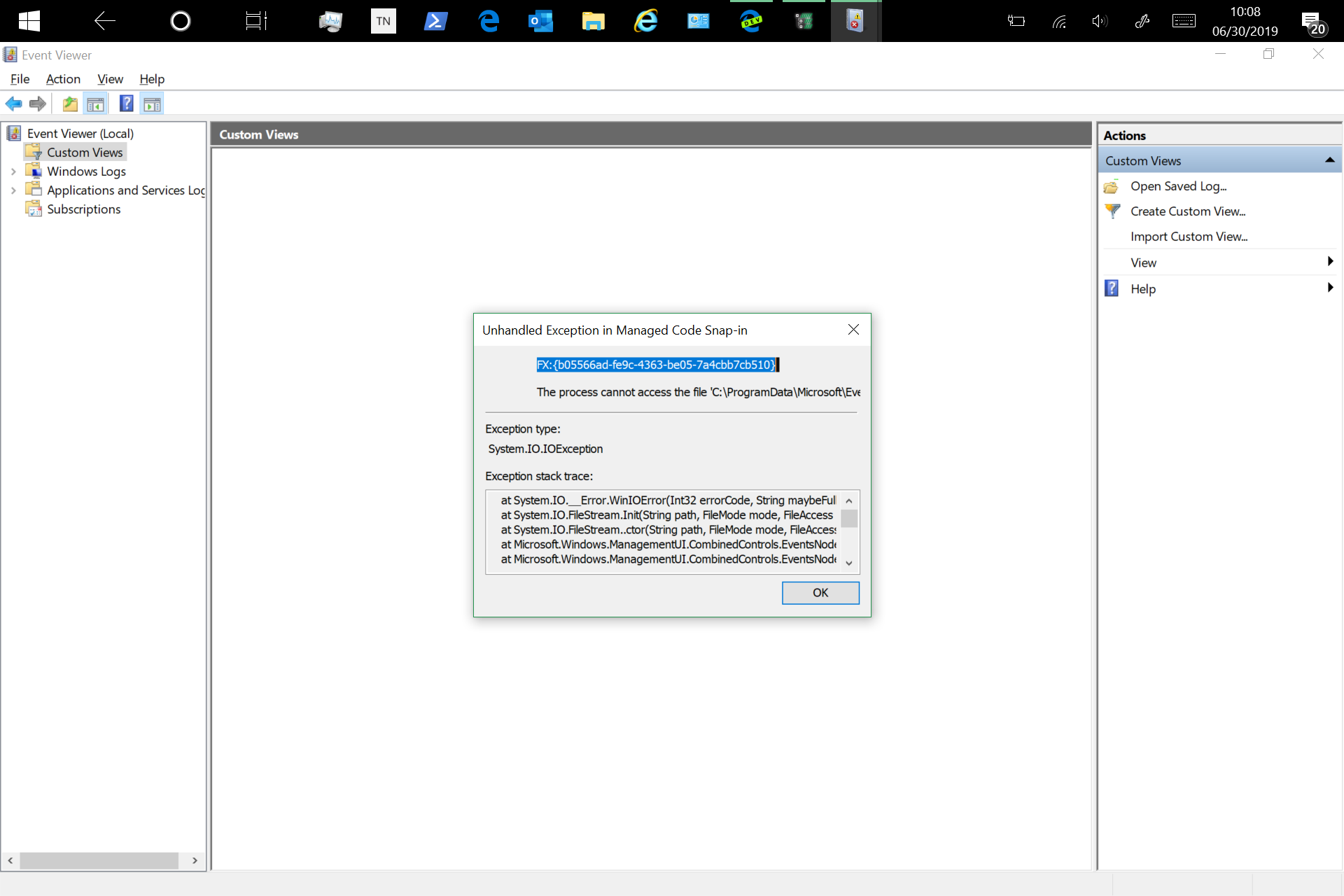

    After opening event viewer, all appears well, and Overview and Summary items in the center viewing pane can be expanded. Clicking 'Custom Views' seemed promising to start, and then threw the following error:
    Unhandled Exception in Managed Code Snap-In
    FX:{b05566ad-fe9c-4363-be05-7a4cbb7cb510}
    The process cannot access the file 'C:\ProgramData\Microsoft\Event Viewer\Views\View_0.xml' because it is being used by another process.
    at System.IO.__Error.WinIOError(Int32 errorCode, String maybeFullPath)
    at System.IO.FileStream.Init(String path, FileMode mode, FileAccess access, Int32 rights, Boolean useRights, FileShare share, Int32 bufferSize, FileOptions options, SECURITY_ATTRIBUTES secAttrs, String msgPath, Boolean bFromProxy, Boolean useLongPath, Boolean checkHost)
    at System.IO.FileStream..ctor(String path, FileMode mode, FileAccess access, FileShare share)
    at Microsoft.Windows.ManagementUI.CombinedControls.EventsNode.get_IsReadOnlyView()
    at Microsoft.Windows.ManagementUI.CombinedControls.EventsNode.UpdateReadOnly()
    at Microsoft.Windows.ManagementUI.CombinedControls.EventsNode.InitializeQueryNode(FileInfo fileInfo)
    at Microsoft.Windows.ManagementUI.CombinedControls.EventsNode.AddSubNodes(DirectoryInfo dir, EventNodeType nodeType, Boolean userQuery, String standardViewConfig)
    at Microsoft.Windows.ManagementUI.CombinedControls.EventsNode.AddSavedQueryNodes()
    at Microsoft.Windows.ManagementUI.CombinedControls.EventsNode.CreateChildNodes()
    at Microsoft.EventViewer.SnapIn.MMCEventsNode.ExpandNode()
    at Microsoft.EventViewer.SnapIn.MMCEventsNode.OnExpand(AsyncStatus status)
    at Microsoft.ManagementConsole.NodeSyncManager.ProcessRequest(NodeRequestInfo info, IRequestStatus requestStatus)
    at Microsoft.ManagementConsole.SnapIn.ProcessRequest(Request request)
    at Microsoft.ManagementConsole.Internal.SnapInClient.Microsoft.ManagementConsole.Internal.IMessageClient.ProcessRequest(Request request)
    at Microsoft.ManagementConsole.Internal.IMessageClient.ProcessRequest(Request request)
    at Microsoft.ManagementConsole.Executive.RequestStatus.BeginRequest(IMessageClient messageClient, RequestInfo requestInfo)
    at Microsoft.ManagementConsole.Executive.SnapInRequestOperation.ProcessRequest()
    at Microsoft.ManagementConsole.Executive.Operation.OnThreadTransfer(SimpleOperationCallback callback)
    Random power offs / Event Viewer MMC snap-in errors / USB failure when battery low b970c344-9d75-4f48-9cc6-f1255fb2e052?upload=true.png
    Random power offs / Event Viewer MMC snap-in errors / USB failure when battery low bb2f6162-6174-4ea9-96ed-8fa637ad8b8a?upload=true.png
    Behavior is pretty much identical no matter what I click, actions pane or the folder/navigation pane.

  2. Robfly Win User
    mmc could not create the snap-in in event viewer (Windows 10)
    I tried the KB but didn't work.
    I found this and it fixed my event viewer mmc error
    1. Open File Explorer on the device.
    2. Navigate to the following path: C:\ProgramData\Microsoft\Event Viewer\Views
    3. Backup the content of the folder. The next step deletes the custom views and you may want the backup to restore the views when Microsoft fixes the issues.
    4. Delete all View_X.xml files in the folder (it starts with View_0.xml and increments the number by 1 for each file).
    5. Start the Event Viewer after deleting the files.
    rob
