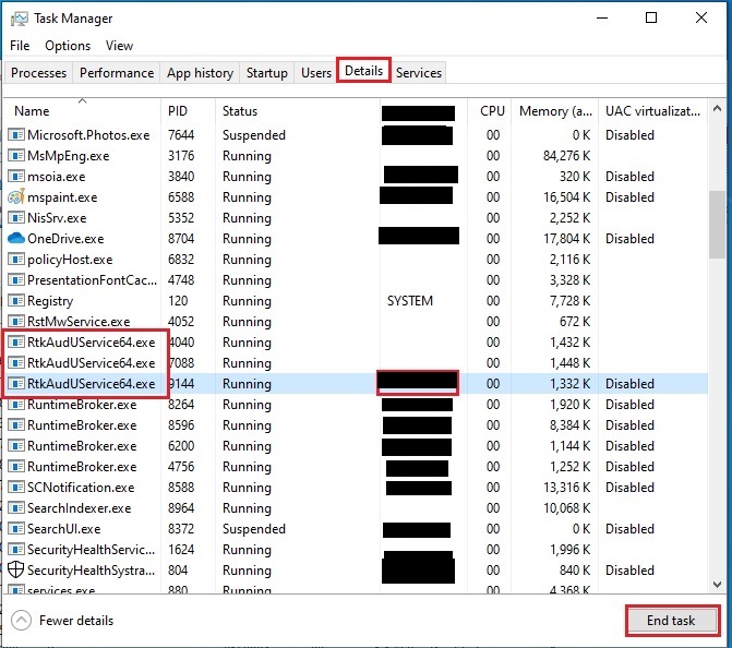

    1. 1. Kill the Process (Standard User)
    · Open the Task manger by right clicking on the task bar and selecting the 'Task Manager' from the context menu.
    · Click on the 'Details' Tab
    · Sort the processes by Name if necessary.
    · Scroll down to the 'RtkAudUService.exe' entries.
    · Select the 'RtkAudUService.exe' entry that has your username represented in the 'User Name' column.
    · Either Right Click the process then select ‘End task’ from the context menu, or Click on the 'End Task' button at the bottom right of the 'Task Manager' window.
    Realtek Audio Driver doesn’t dynamically switch between PC Speaker and the Headphone Jack... 2da62bcc-dff2-4c30-9d7f-c7ee4cfd462f?upload=true.jpg

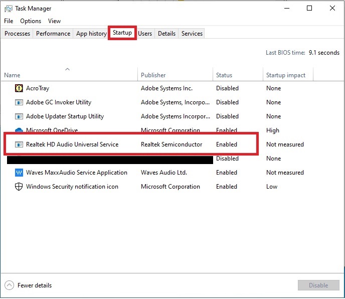

    2. 2. Disable User Context Service Startup (Administrator)
    · Select the Startup Tab
    Realtek Audio Driver doesn’t dynamically switch between PC Speaker and the Headphone Jack... c61658ab-fde5-46fd-8b83-c0ce87806b06?upload=true.jpg
    · Select the 'Realtek HD Audio Universal Service' and either Right Click and select 'Disable' option from the context menu or click on the 'Disable' Button at the bottom right of the Task Manager window.
