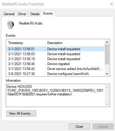

    Hello!
    My realtek audio device in device manager says it needs to further install something but I have no idea where it is. My pc has been acting up ever since I replaced my motherboard and I've been trying relentlessly to fix it. My main goal is to stream video games but it has trouble running OBS and games at the same time so I have no idea what the issue is because the motherboard is the only new item I replaced. Everything worked fine when I was using an MSI B450 Tomahawk Motherboard then when I changed to the ASRock B550 Steel Legend everything started going downhill from there. Idk if it's the audio driver itself being the problem or what because latencymon says a bunch of stuff shown below but I just have no clue anymore. I've done quite a few things to try and fix my pc but nothing seems to work. I just want to at least record games in OBS without my PC being real choppy or laggy when I record.
    Components:
    Mobo: ASRock B550 Steel Legend
    CPU: AMD Ryzen 5 3600
    RAM: GSkill TridentZ Neo DDR4 3600 32GB
    GPU: MSI Geforce RTX 2060
    SSD: Samsung EVO 860 1TB
    HDD: Seagate Barracuda 2TB
    Device HDAUDIO\FUNC_01&VEN_10EC&DEV_1220&SUBSYS_18492225&REV_1001\5&a6931f1&0&0001 requires further installation.
    Realtek Audio Requires further installation 464ab7d9-1019-4c04-80a6-ba53f16d65bb?upload=true.png
    Realtek Audio Requires further installation edeefd70-cb38-4768-aeba-5109409af595?upload=true.png

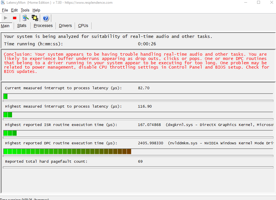

    _________________________________________________________________________________________________________
    CONCLUSION
    Your system appears to be having trouble handling real-time audio and other tasks. You are likely to experience buffer underruns appearing as drop outs, clicks or pops. One or more DPC routines that belong to a driver running in your system appear to be executing for too long. One problem may be related to power management, disable CPU throttling settings in Control Panel and BIOS setup. Check for BIOS updates.
    LatencyMon has been analyzing your system for 0:02:26 h:mm:ss on all processors.
    SYSTEM INFORMATION
    Computer name: YAMANASHI-PC
    OS version: Windows 10, 10.0, version 2009, build: 19042 x64
    Hardware: To Be Filled By O.E.M., To Be Filled By O.E.M.
    CPU: AuthenticAMD AMD Ryzen 5 3600 6-Core Processor
    Logical processors: 12
    Processor groups: 1
    RAM: 32693 MB total
    CPU SPEED
    Reported CPU speed: 3593 MHz
    Note: reported execution times may be calculated based on a fixed reported CPU speed. Disable variable speed settings like Intel Speed Step and AMD Cool N Quiet in the BIOS setup for more accurate results.
    MEASURED INTERRUPT TO USER PROCESS LATENCIES
    The interrupt to process latency reflects the measured interval that a usermode process needed to respond to a hardware request from the moment the interrupt service routine started execution. This includes the scheduling and execution of a DPC routine, the signaling of an event and the waking up of a usermode thread from an idle wait state in response to that event.
    Highest measured interrupt to process latency µs: 312.90
    Average measured interrupt to process latency µs: 5.999007
    Highest measured interrupt to DPC latency µs: 308.20
    Average measured interrupt to DPC latency µs: 2.572193
    REPORTED ISRs
    Interrupt service routines are routines installed by the OS and device drivers that execute in response to a hardware interrupt signal.
    Highest ISR routine execution time µs: 195.540217
    Driver with highest ISR routine execution time: dxgkrnl.sys - DirectX Graphics Kernel, Microsoft Corporation
    Highest reported total ISR routine time %: 0.171284
    Driver with highest ISR total time: dxgkrnl.sys - DirectX Graphics Kernel, Microsoft Corporation
    Total time spent in ISRs % 0.183860
    ISR count execution time <250 µs: 391922
    ISR count execution time 250-500 µs: 0
    ISR count execution time 500-1000 µs: 0
    ISR count execution time 1000-2000 µs: 0
    ISR count execution time 2000-4000 µs: 0
    ISR count execution time >=4000 µs: 0
    REPORTED DPCs
    DPC routines are part of the interrupt servicing dispatch mechanism and disable the possibility for a process to utilize the CPU while it is interrupted until the DPC has finished execution.
    Highest DPC routine execution time µs: 2432.379627
    Driver with highest DPC routine execution time: nvlddmkm.sys - NVIDIA Windows Kernel Mode Driver, Version 461.72 , NVIDIA Corporation
    Highest reported total DPC routine time %: 0.080245
    Driver with highest DPC total execution time: Wdf01000.sys - Kernel Mode Driver Framework Runtime, Microsoft Corporation
    Total time spent in DPCs % 0.241379
    DPC count execution time <250 µs: 442182
    DPC count execution time 250-500 µs: 0
    DPC count execution time 500-10000 µs: 27
    DPC count execution time 1000-2000 µs: 0
    DPC count execution time 2000-4000 µs: 29
    DPC count execution time >=4000 µs: 0
    REPORTED HARD PAGEFAULTS
    Hard pagefaults are events that get triggered by making use of virtual memory that is not resident in RAM but backed by a memory mapped file on disk. The process of resolving the hard pagefault requires reading in the memory from disk while the process is interrupted and blocked from execution.
    NOTE: some processes were hit by hard pagefaults. If these were programs producing audio, they are likely to interrupt the audio stream resulting in dropouts, clicks and pops. Check the Processes tab to see which programs were hit.
    Process with highest pagefault count: dllhost.exe
    Total number of hard pagefaults 357
    Hard pagefault count of hardest hit process: 204
    Number of processes hit: 15
    PER CPU DATA
    CPU 0 Interrupt cycle time s: 8.412193
    CPU 0 ISR highest execution time µs: 195.540217
    CPU 0 ISR total execution time s: 3.084086
    CPU 0 ISR count: 170783
    CPU 0 DPC highest execution time µs: 2418.482605
    CPU 0 DPC total execution time s: 3.090364
    CPU 0 DPC count: 315201
    CPU 1 Interrupt cycle time s: 2.315850
    CPU 1 ISR highest execution time µs: 96.467576
    CPU 1 ISR total execution time s: 0.088597
    CPU 1 ISR count: 111524
    CPU 1 DPC highest execution time µs: 2432.379627
    CPU 1 DPC total execution time s: 1.037428
    CPU 1 DPC count: 112304
    CPU 2 Interrupt cycle time s: 0.462303
    CPU 2 ISR highest execution time µs: 12.915113
    CPU 2 ISR total execution time s: 0.003693
    CPU 2 ISR count: 4146
    CPU 2 DPC highest execution time µs: 144.200390
    CPU 2 DPC total execution time s: 0.049999
    CPU 2 DPC count: 4839
    CPU 3 Interrupt cycle time s: 0.325153
    CPU 3 ISR highest execution time µs: 8.89730
    CPU 3 ISR total execution time s: 0.000179
    CPU 3 ISR count: 119
    CPU 3 DPC highest execution time µs: 149.460618
    CPU 3 DPC total execution time s: 0.004745
    CPU 3 DPC count: 280
    CPU 4 Interrupt cycle time s: 0.336593
    CPU 4 ISR highest execution time µs: 1.052046
    CPU 4 ISR total execution time s: 0.000008
    CPU 4 ISR count: 12
    CPU 4 DPC highest execution time µs: 113.150014
    CPU 4 DPC total execution time s: 0.005067
    CPU 4 DPC count: 1166
    CPU 5 Interrupt cycle time s: 0.318007
    CPU 5 ISR highest execution time µs: 0.0
    CPU 5 ISR total execution time s: 0.0
    CPU 5 ISR count: 0
    CPU 5 DPC highest execution time µs: 90.465906
    CPU 5 DPC total execution time s: 0.004609
    CPU 5 DPC count: 1121
    CPU 6 Interrupt cycle time s: 0.296160
    CPU 6 ISR highest execution time µs: 0.0
    CPU 6 ISR total execution time s: 0.0
    CPU 6 ISR count: 0
    CPU 6 DPC highest execution time µs: 27.363206
    CPU 6 DPC total execution time s: 0.001381
    CPU 6 DPC count: 356
    CPU 7 Interrupt cycle time s: 0.282940
    CPU 7 ISR highest execution time µs: 0.0
    CPU 7 ISR total execution time s: 0.0
    CPU 7 ISR count: 0
    CPU 7 DPC highest execution time µs: 43.334261
    CPU 7 DPC total execution time s: 0.001004
    CPU 7 DPC count: 201
    CPU 8 Interrupt cycle time s: 0.595244
    CPU 8 ISR highest execution time µs: 7.474534
    CPU 8 ISR total execution time s: 0.043668
    CPU 8 ISR count: 97010
    CPU 8 DPC highest execution time µs: 96.307264
    CPU 8 DPC total execution time s: 0.025693
    CPU 8 DPC count: 4569
    CPU 9 Interrupt cycle time s: 0.417490
    CPU 9 ISR highest execution time µs: 1.833565
    CPU 9 ISR total execution time s: 0.001241
    CPU 9 ISR count: 2515
    CPU 9 DPC highest execution time µs: 114.592819
    CPU 9 DPC total execution time s: 0.007583
    CPU 9 DPC count: 1363
    CPU 10 Interrupt cycle time s: 0.292861
    CPU 10 ISR highest execution time µs: 2.985806
    CPU 10 ISR total execution time s: 0.000928
    CPU 10 ISR count: 1688
    CPU 10 DPC highest execution time µs: 124.632341
    CPU 10 DPC total execution time s: 0.002185
    CPU 10 DPC count: 363
    CPU 11 Interrupt cycle time s: 0.363131
    CPU 11 ISR highest execution time µs: 3.777345
    CPU 11 ISR total execution time s: 0.001941
    CPU 11 ISR count: 4125
    CPU 11 DPC highest execution time µs: 120.053437
    CPU 11 DPC total execution time s: 0.002981
    CPU 11 DPC count: 475

    3. Find Realtek High Definition Audio
    4. Right click and hit update driver
    5. Browse my computer for driver software
    6. Let me pick from a list of available drivers on my computer
    7. Click Have Disk and hit browse
    8. Click on the Realtek HD Audio mod folder and look for win64
    9. Click on the HDXRT4 and click ok,
    10. Click Next and Yes
    additional if you want dts audio and others, install it now before next step.
    After it is done, restart the PC
    You should be good then and also make sure before doing these steps that you have driver enforcement disabled.
    Jayce, Mar 15, 2021
