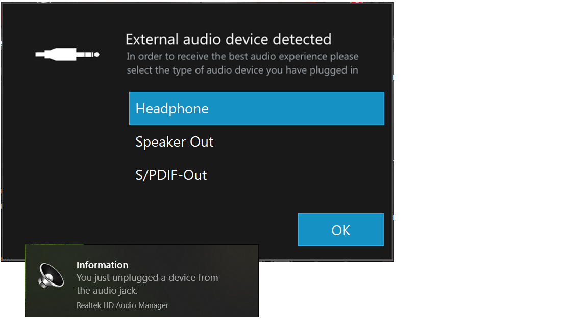

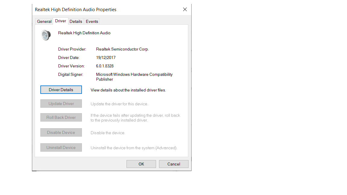

    I have spent many days trying to fix this problem but have still not solved it.

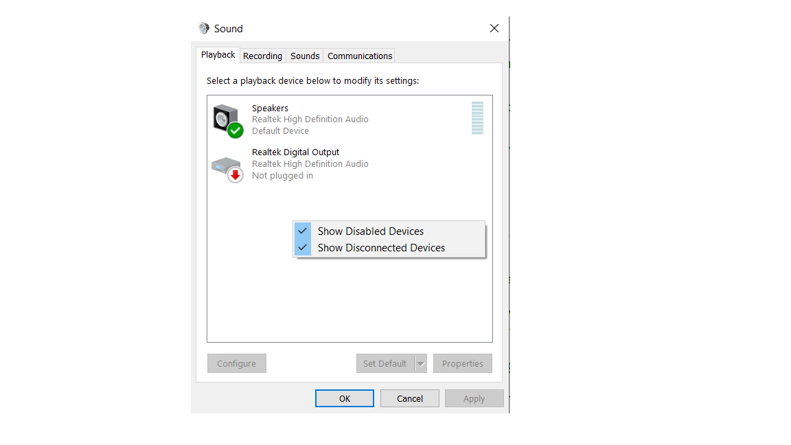

    Basically I want to set headphones as my default output instead of speakers but when I open up the sound settings there is no option for headphones. (I have not disabled or disconnected it).

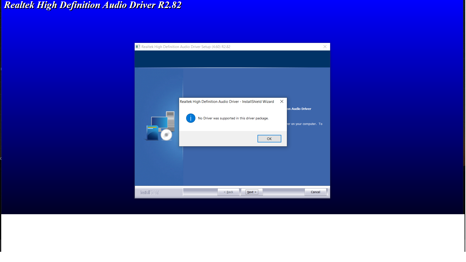

    I have updated, uninstalled and reinstalled all my sound drivers and it still is not working, so I went to re-install the realtek HD audio manager but when running the installation it states "No Driver was supported in this driver package" I have also tried this with an earlier version and get the same error.

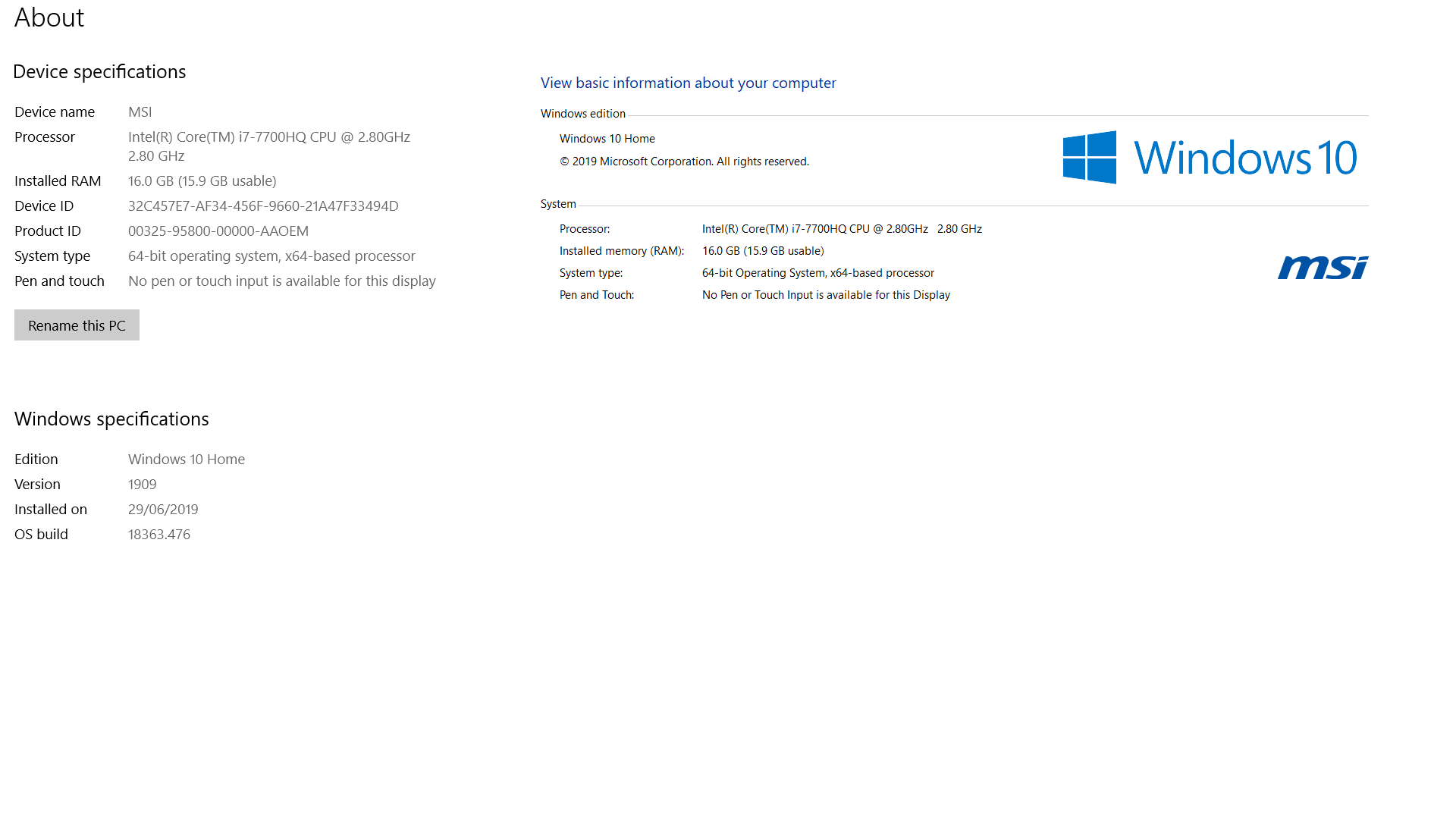

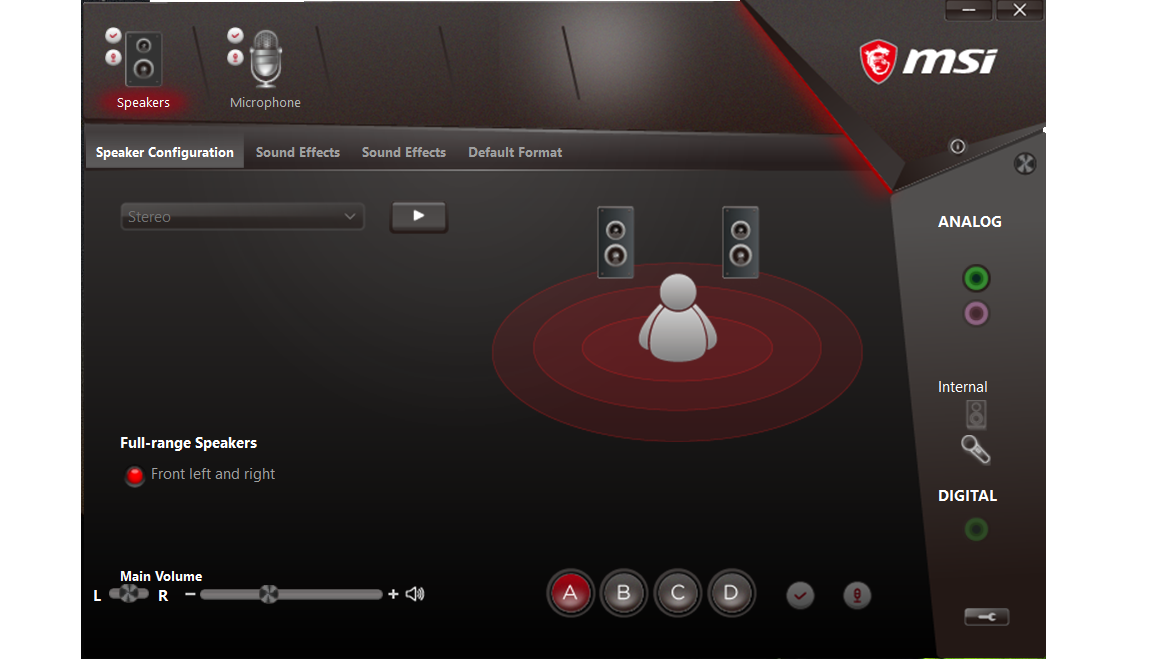

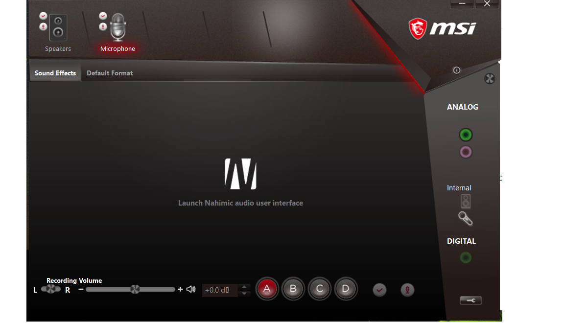

    In addition to all this I cannot get my microphone working but i am assuming this is related to this issue. I have attached images below of all the details needed. In the sound settings it tells me that the realtek digital output is not plugged in but this is not an external sound card? I really need some help on this all my PC details are also attached in the images. In the microphone section I am unable to open a Nahimic audio user interface. The first picture are the messages that come up when I plug my headphones in and I always select the headphone option. No matter what i do I cannot set headphones as my default output; It is not even a selectable option currently! Not sure what else to include but hopefully this will be enough!
    Realtek HD Audio Driver "Not Plugged In" 1670afa1-93d1-45c6-abe1-a5317c992c58?upload=true.png Realtek HD Audio Driver "Not Plugged In" b2674d1b-ce8b-42fd-9bc6-33bb4e8dee0f?upload=true.png Realtek HD Audio Driver "Not Plugged In" 62982357-b001-4a9b-8399-ee320a5a4228?upload=true.png Realtek HD Audio Driver "Not Plugged In" 2df0313e-eafa-474e-b12e-0f34cfad4730?upload=true.png Realtek HD Audio Driver "Not Plugged In" 5d1bc372-3f78-4384-8b9d-2c6684600e87?upload=true.png Realtek HD Audio Driver "Not Plugged In" 49f57432-9ca2-44f6-890e-4cab1cb2f54d?upload=true.png Realtek HD Audio Driver "Not Plugged In" c1f2260b-d4aa-4490-ae88-952734b02e01?upload=true.png Realtek HD Audio Driver "Not Plugged In" 696bef34-abb0-4afc-8ffb-760be955ea0f?upload=true.png
    Pixel_Waffle_, Nov 30, 2019

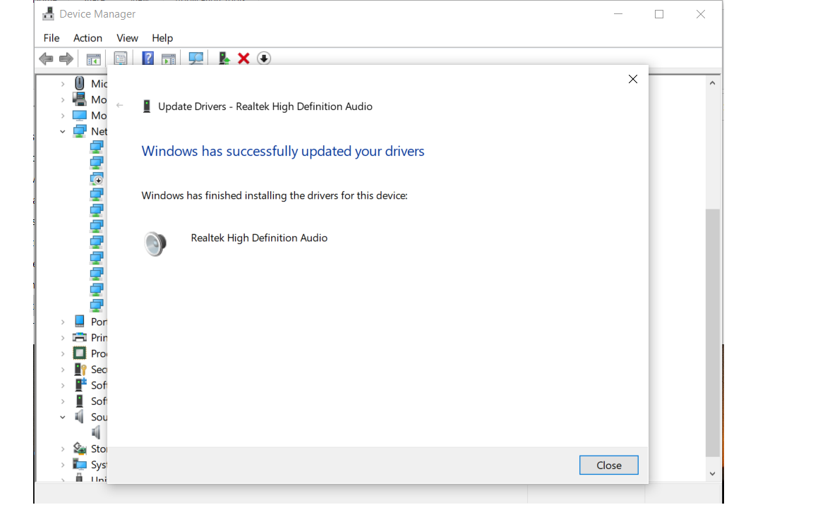

  3. Jayce Win User
    The Ultimate Realtek HD Audio Driver Mod for Windows 10
    I had the realtek error when using the installer, so I did these step and It Worked
    1.Go Open up device manager
    2. Go under sound,video, and game controllers
    3. Find Realtek High Definition Audio
    4. Right click and hit update driver
    5. Browse my computer for driver software
    6. Let me pick from a list of available drivers on my computer
    7. Click Have Disk and hit browse
    8. Click on the Realtek HD Audio mod folder and look for win64
    9. Click on the HDXRT4 and click ok,
    10. Click Next and Yes
    After it is done, restart the PC
    You should be good then and also make sure before doing these steps that you have driver enforcement disabled.
    Jayce, Nov 30, 2019
