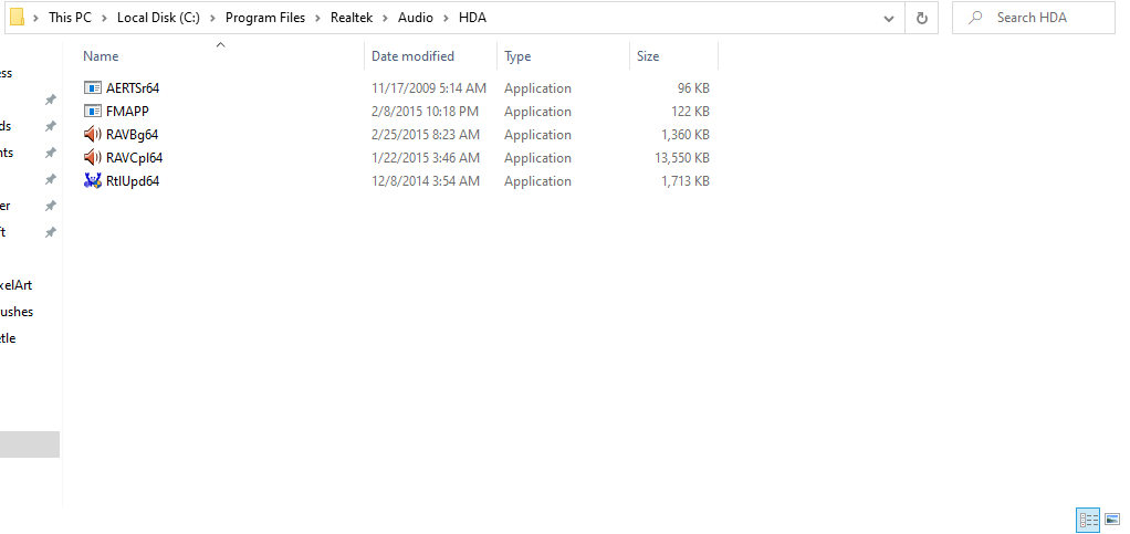

    I did a windows update recently and now my audio doesn't work at all I've tried mostly all the fixes and Realtek shows up nowhere. Realtek HD Audio Manager is gone everywhere after windows update 67dadf14-3035-4d57-b33a-64dce2a22380?upload=true.png
    In the above image, there is no RtkNGUI64.exe

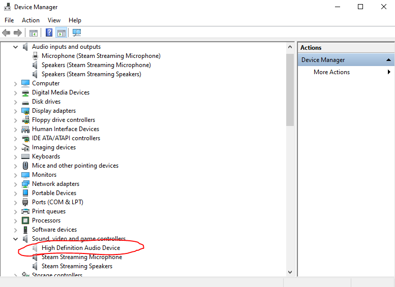

    Realtek HD Audio Manager is gone everywhere after windows update b9802a1f-2ccc-45d4-9f4d-4edb38c2fdd1?upload=true.png
    The circled device is hidden and there was another one that was also disabled labeled "Realtek High Definition Audio Device". The only problem is following other threads I came across a possible fix that said to delete the device and restart the pc, It didn't work so now that device is gone.

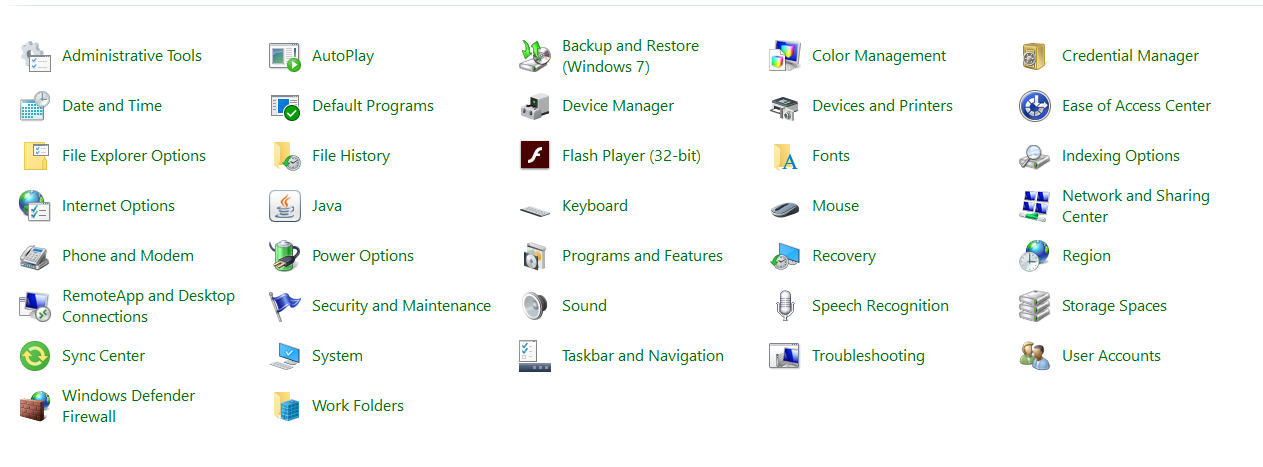

    Realtek HD Audio Manager is gone everywhere after windows update 31d10219-2951-4265-963d-b4486949479f?upload=true.png
    And lastly, as you can see no Realtek Audio Here as well.
    I've tried re-installing the drivers and it doesn't work. I've re-installed it 4 times. And I cannot uninstall it as I cannot access it in the device manager.
    If you have any idea how to fix this please help I have absolutely no idea.
