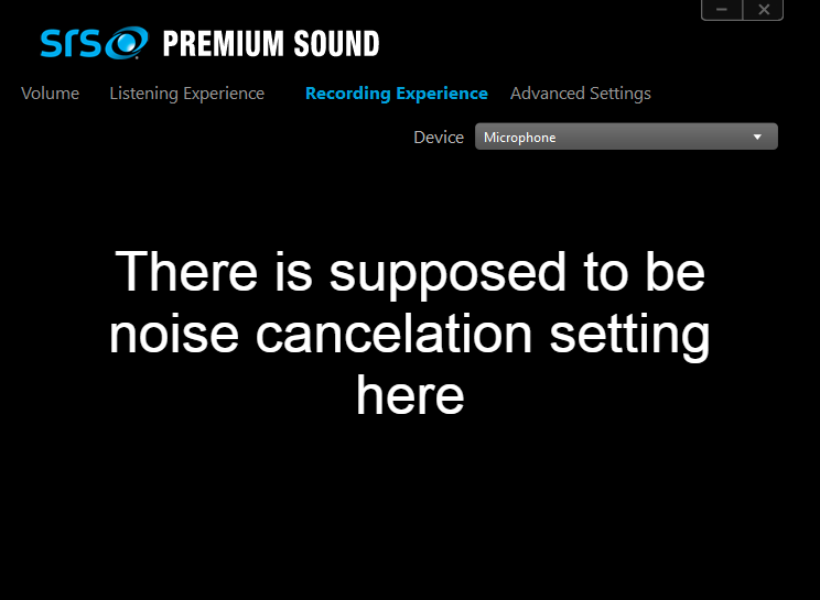

    I don't know what I did but almost out of nowhere the recording experience menu isn't showing up, I haven't upgraded my PC or messed with the "SRS Premium Sound" menu at all but for some reason it isn't letting me use the recording experience menu. and Yes my Microphone does work RealTek SRS Premium Sound Recording Experience isn't working cbdf114b-639a-406f-9193-c07db160652f?upload=true.png
