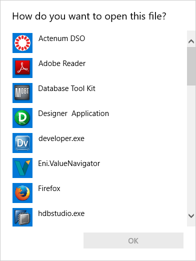

    I have the code below. It worked on my old windows machine but now the code does not work for my Windows 10 machine. Thoughts? Here is the code and message I get. It asks me how do I want to open the file (picture below). Also, can I store this file on OneDrive and update in daily by using the Task Scheduler?
    Dim oExcel
    Set oExcel = CreateObject("Excel.Application")
    oExcel.Visible = True
    oExcel.DisplayAlerts = False
    oExcel.AskToUpdateLinks = False
    oExcel.AlertBeforeOverwriting = False
    Set oWorkbook = oExcel.Workbooks.Open("L:\Location\Test.xlsx")
    oWorkbook.RefreshAll
    oWorkbook.Save
    oExcel.Quit
    Set oWorkbook = Nothing
    Set oExcel = Nothing

  2. Running a VB Script File Using Windows 10 Task Scheduler
    Please post your current version of the script.
    Note also that I'll be off the air for a whole week, starting this coming Sunday evening. With your response cycle of one reply per day, you are unlikely to solve your problem anytime soon. This is aggravated by you consistenly posting insufficient information
    (e.g. repeatedly not posting your script, not posting numbers of problem lines, taking numerous attempts to post the exported xml file etc. etc.). You need to remember that respondents cannot see your screen.
    Lastly - you are trying to use the Task Scheduler to launch a script to open an Excel file to launch a macro. This is an extremely ambitious task. It is also not a good way to do things. A script can do everything that a macro can, and more, but more simply.
    Forget about the macro. Here are the steps you should take:
    • Get my script going in the foreground.
    • Get it going while scheduled.
    • Write a script that opens an Excel file.
    • Run it in the foreground.
    • Run it in the background.
    • Expand it to manipulate the spreadsheet.
    Frederik Long, Mar 19, 2019
  3. Peer_Sam Win User
    Task Scheduler doesn't run script
    Are you able to run the script manually? If yes, does it do what it is intended to?
    Disable the UAC temporarily.
    Make sure that the Task scheduler
    service is running.
    Press ‘Win+R’.
    Type Services.msc.
    Locate the service Task scheduler
    and make sure that it is in running state.
    Go to the Conditions
    tab in task scheduler and make sure that no such condition is set which could block the task from running.
    Enable All Tasks History in Task scheduler and run the scheduled task.
    Refresh the task scheduler and check if you find any error message/code for any step in the task run.
    Also try with disabling Run whether the user is logged on or not
    option and see if the script runs.
    Hope it helps.
    Peer Samie
    Microsoft Community-Moderator
    Peer_Sam, Mar 19, 2019
