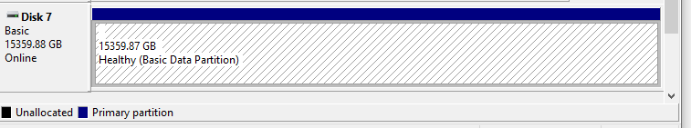

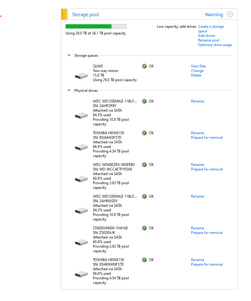

  1. ReFS Storage Space Volume fails to mount
    I have 2-way mirrored storage space that reads as healthy when the ReFS volume is unmounted. The problem is when I try to mount it via diskmgmt, explorer will hang forever with System using about 10% CPU forever. I've tried leaving this process running for 4 days and it did not seem to complete any long running process.
    Once the mount process is triggered, my system becomes unable to boot until I remove the disks, which disables the volume from attempting to be mounted. I then run automount off and automount scrub from diskpart to regain the ability to examine the Storage Space and unmounted volume when the disks are reattached. I'm desperately looking for either a way to copy the files off of this volume or some mechanism to repair this situation.
    I'm currently running on Windows 10 Enterprise Insider Build 19043.906. This issue started occurring about a month ago when I was on the latest stable release after a reboot. I already tried resetting the OS, and then I tried moving to Insider builds to see if this was resolved there, but it is not.
