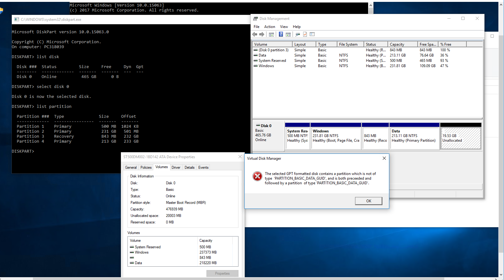

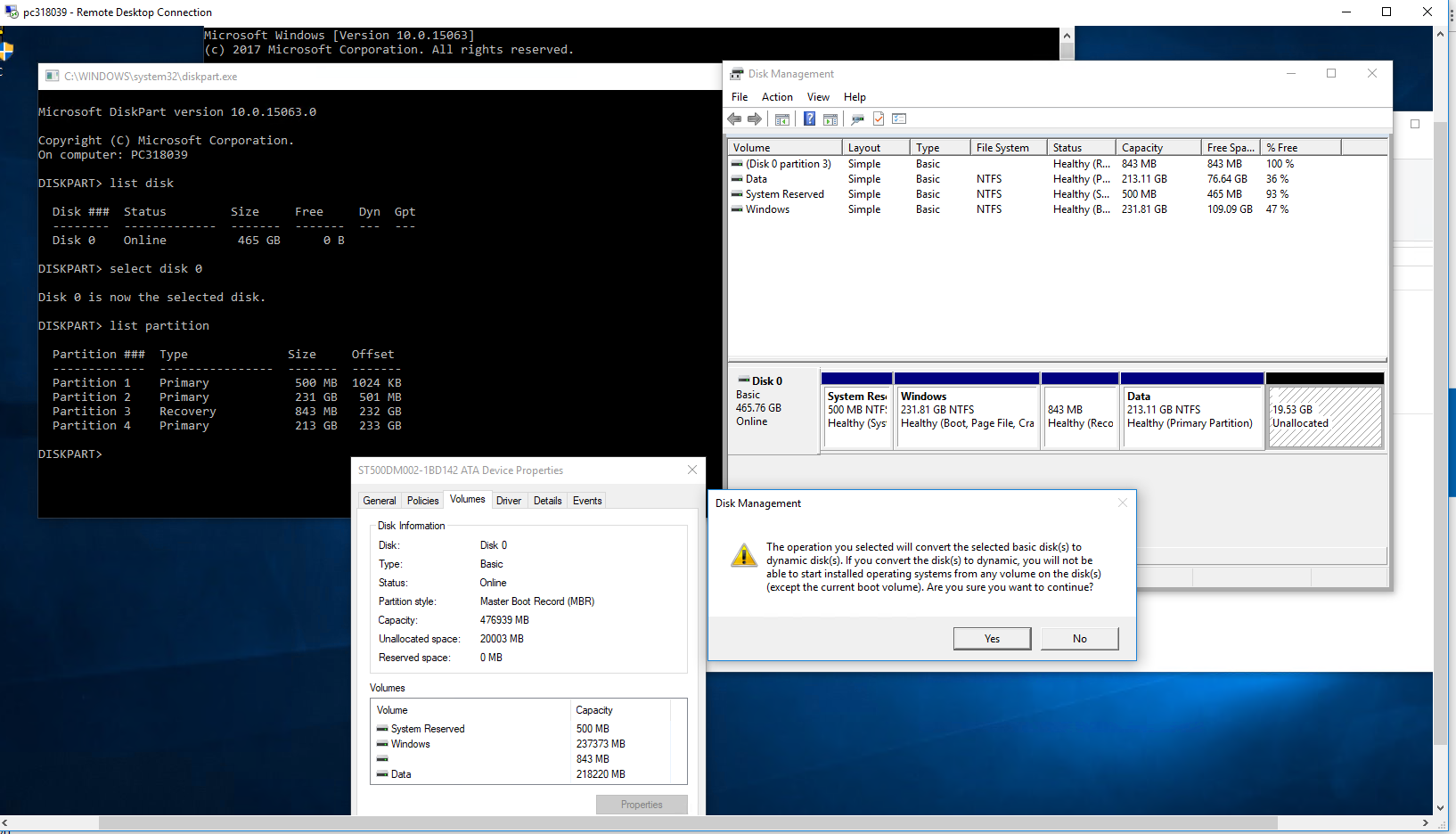

    Hi all,
    I am trying to Partition my disk in my desktop , i have 2 partitions in my Disk-0 (C-drive and D-drive), i have successfully shrinked my D-drive from disk management and it has created a unallocated space of 20 GB
    When i am trying to create a New partition with the unallocated space i am getting error as The selected GPT formatted disk contains a partition which is not of the type 'PARTITION_BASIC_DATA_GUID', and
    is both preceeded and followed by a partition of type 'PARTITION_BASIC_DATA_GUID' (As per the image1 below i am getting warning while creating the new volume and getting error while creating it as per image2) Regarding Disk partition 5b361289-1d90-4e9d-9acd-f9a5af1f0fe2?upload=true.png Regarding Disk partition c13f053b-9ae3-40f0-9076-135e422edde5?upload=true.png )
    Guys i'm stuck here
    As checked from disk partition my Disk partition style is MBR
    Your assistance would be of great help
    Regards
    Sandeep
