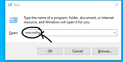

    Next press windows key, then again windows key+r and then it will show this: Remix OS Remove from dual boot the EASY WAY a9657e70-e56a-49a0-bfc0-e6b113988804?upload=true.png Then type msconfig as shown in the picture.

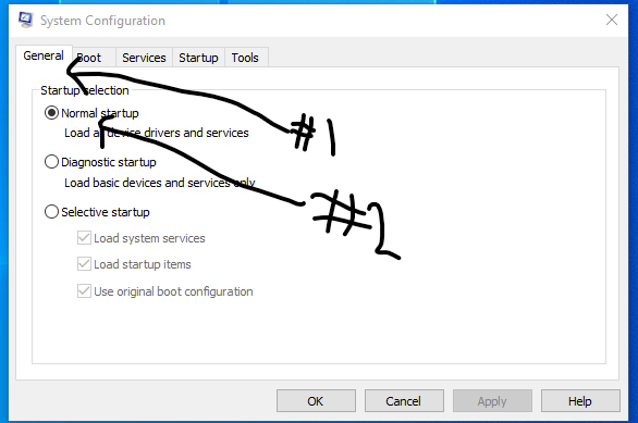

    First go to the "General" tab next to the "Boot" tab and then press normal startup. After this press apply on the bottom right. It will ask you to go to restart for your changes to be made. Press Restart.
    Now after the restart your computer will load with the dots in a circle, For me it did it may be different for you but if you did this correctly you shouldn't see the Remix OS and Remix OS Advanced options thing.
    Hoped this answered anybody with this question.

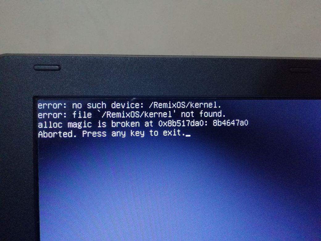

    But it is still showing in dual boot. When I select Remix OS to boot it shows error(included in image)-

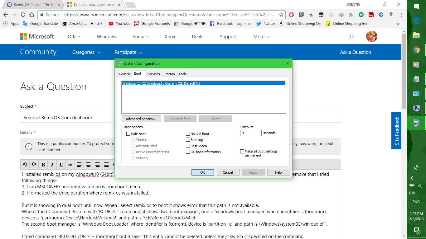

    I ran MSCONFIG again but it is listing only one OS (following image)-
    Remix OS Remove from dual boot the EASY WAY 35950e8f-5e66-4eb0-879f-9afe05472c98?upload=true.png
    Then I tried EasyBCD tool, but it is also listing only one entry i.e. Windows.

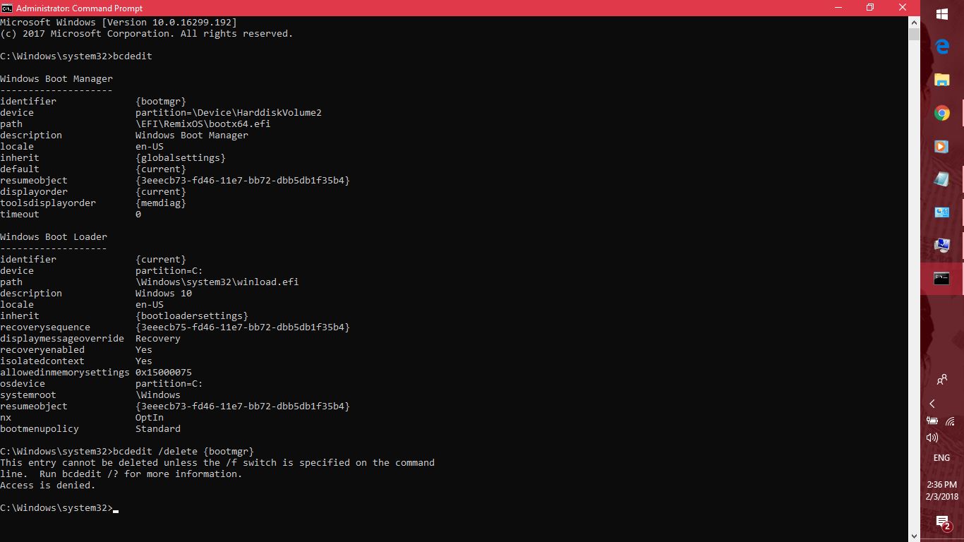

    When I tried Command Prompt with 'BCDEDIT' command, it shows two boot manager, one is 'windows boot manager' where identifier is {bootmgr}, device is 'partition=\Device\HarddiskVolume2' and path is '\EFI\RemixOS\bootx64.efi'.
    The second boot manager is 'Windows Boot Loader' where identifier is {current}, device is 'partition=c:' and path is \Windows\system32\winload.efi'. (following image)-
    Remix OS Remove from dual boot the EASY WAY 54e1b3df-c2a5-468f-ac59-a9e8a827ee28?upload=true.png
    I tried command 'BCDEDIT /DELETE {bootmgr}' but it says "This entry cannot be deleted unless the /f switch is specified on the command line. Run bcdedit /? for more information.
    Access is denied."
    Remix OS Remove from dual boot the EASY WAY 46dcbf62-8773-402c-ad77-50c6fd08a8a5?upload=true.png
    I am totally confused right now.
    Please tell me what to do now?
