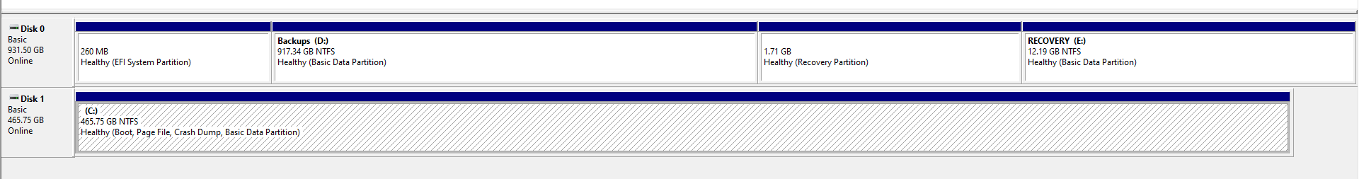

    I installed an SSD on my Laptop. I did a fresh install of Windows 10 on the SSD and formatted the old HDD, but somehow when I boot up my laptop it still goes to the Windows Boot Manager asking which operating system to use. I probably made a mistake because the HDD still has Partitions for Recovery, and EFI System.
    Remove OS from OLD Hard Disk Drive e61b38a7-76cd-447a-89c6-a0443d87f8ff?upload=true.png
    Here's what I've done to get to this point:
    1. Install SSD
    2. Install Windows on SSD using USB
    3. Format the Windows partition on the HDD Backups D:\

    There's a possibility that your HDD was detected as OS drive during the Windows installation. To remove your HDD as system disk, we suggest reformatting it. To do so, please follow the steps below:
    • Open Disk Management.
    • Right-click on your HDD, then select Format.
    • On the Format windows, type your preferred Volume label,
      File system (NTFS is recommended)
      , Allocation unit size (leave as Default).
    • Check the Perform a quick format option, then click
      OK
    Note: Please back up your files before reformatting the drive.
