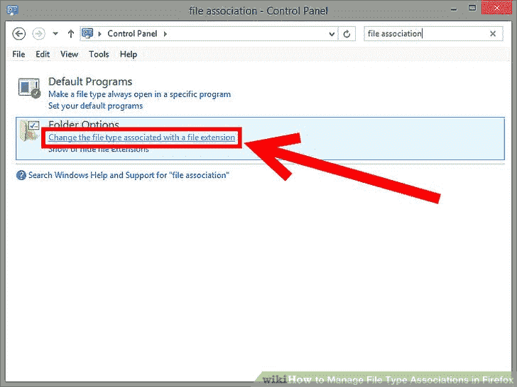

    Over time, Microsoft is migrating more and more settings from the Control Panel to the Settings app of Windows 10 but this led to a few issues in Control Panel.
    For example, when opening Control Panel and searching for the setting file association in the search bar
    Removed Control Panel settings makes Explorer crash f5240df3-7a50-4c84-b07a-3d0cdf3f9aeb?upload=true.png
    Clicking on that marked would make the tasbar and desktop refresh and then open the modern Windows Settings app. However, an APPCRASH of Explorer would also appear in the Reliability History with the following log:
