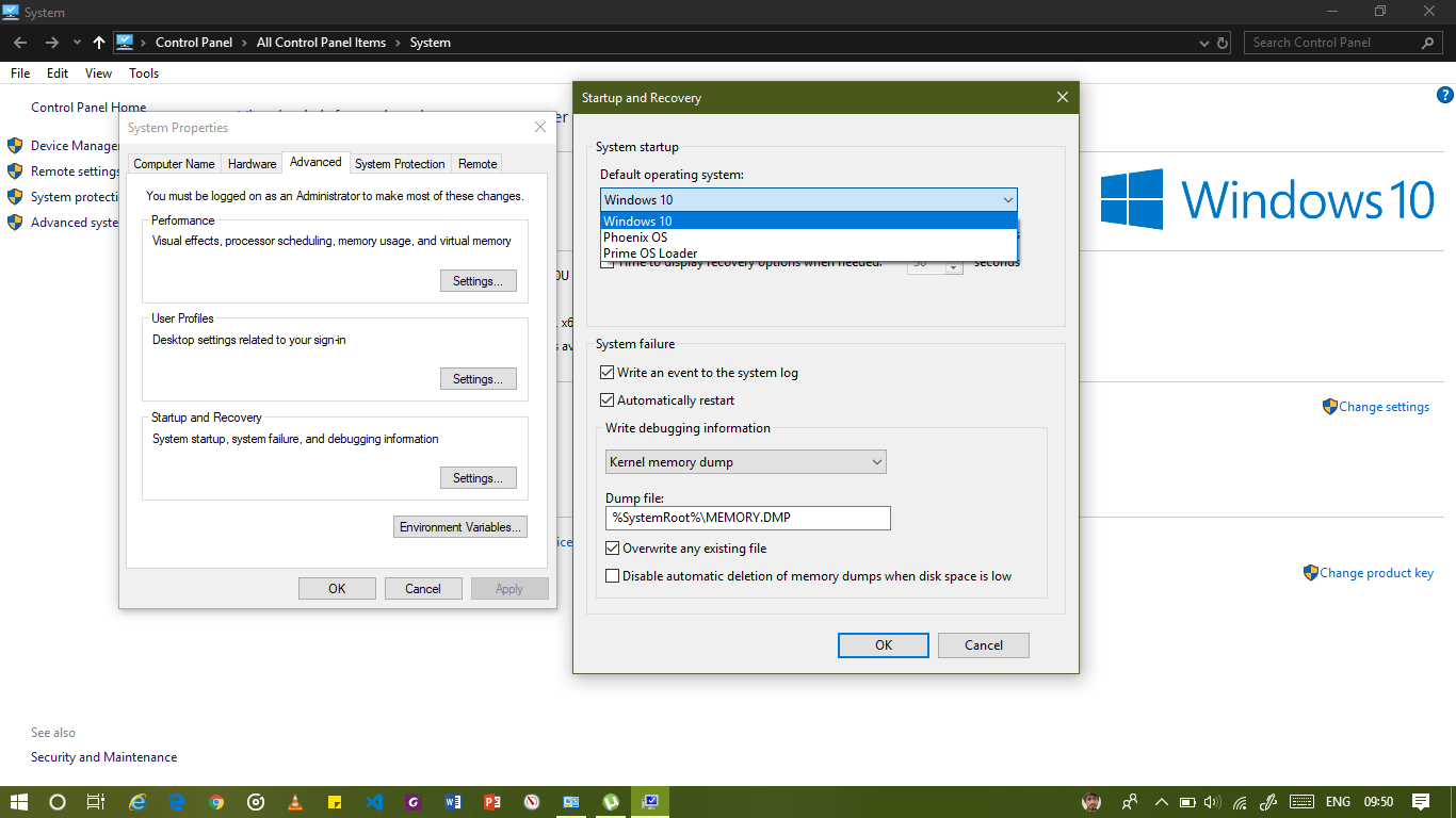

    How can I remove an operating system entry from "choose an operating system" option at startup. I've manually deleted those extra operating systems but didn't knew that it would cause this problem. It only shows up here, I can not find any other files of Prime OS and Phoenix OS. Removing an unwanted "choose an operation system option". ba603710-4de9-4c36-9e0c-17a39faafaee?upload=true.png

  4. Removing an unwanted "choose an operation system option".
    Turning off unwanted operating systems
    I understand the issue that you are currently facing, we will try the best we can to resolve your issue.
    Perform the steps below and check if it helps.
    1. Press Windows + X, then
    Select System.
    2. Click/tap on the Advanced system settings link on the left, and close the System window.
    3. Click/tap on the Settings button under
    Startup and Recovery.
    4. Select the OS (ex: Windows 10) you want as the default in the Default operating system drop down menu, and click/tap on
    OK.
    5. Restart the PC.
    Choose Windows 10 default and uncheck the option Time to display the list of operating system.
    Hope this helps in resolving the issue. If issue persists, do get back to us. We will be happy to assist you.
