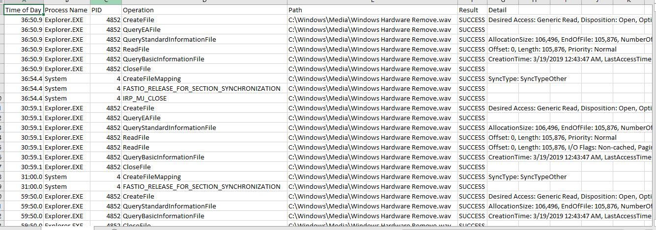

    I ran Process Monitor and filtered for any actions that were activating that Windows Hardware Remove.wav file and got the following results that seem to point to Explorer.exe.
    Repeated Hardware Remove.wav sound when computer sleeps 9b3e8476-7ce5-4fa6-a697-56b9486f0119?upload=true.jpg

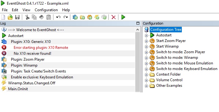

    EventGhost shows an error regarding x10 Remote, but I don't even know what that is. Possible culprit?
