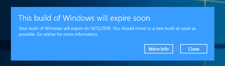

    For the past week or so, Windows 10 would display the "This Build of Windows will expire soon" notification on the desktop PC.
    I assumed at first that I had not updated to the latest build but a check under Settings > Update & Security returned no new builds.
    Resolve "This Build of Windows will expire soon" notification on Windows 10 this-build-of-windows-will-expire-soon.png

    I opened Settings > Update & Security > Windows Insider Program for clues, and found plenty. All options on the page were grayed out and not selectable. The content setting was set to "Active Development of Windows", and the pace in which new builds were delivered to "Slow".
    I noticed on the page that no Windows Insider Account was linked to the program; that was odd, as I had an account linked to the program from the very first time I set it up.
    I clicked on the add button to link that account again to the Insider Program. It was displayed right away as an option and I did not have to enter any data, e.g. a password for verification.
    As soon as I did that, Windows would unlock the options. I could switch to the Fast Ring again, and a check under Windows Update returned the latest Insider Build which I started to download and install.
    I did not unlink the account from the Insider program; this must have happened automatically somehow.
    Anyway, if you run into the same issue, make sure you check if an account is linked to the program.
