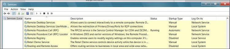

    Hi, please review the state of your services vs this:
    Restore Default Services in Windows 10
    Have you ever changed the state of any of your services, or chosen to disable any?
    RPC: I have
    RPC server. 351597d1637009387t-credential-manager-0x800706ba-rpc-server-unavailable-1.jpg
    I can confirm my Credential Manager starts.
    Observing the cautious preparatory steps prompted by this free tool:
    RPC server. 351598d1637009555t-credential-manager-0x800706ba-rpc-server-unavailable-1.jpg
    you might try only selected repairs- there are at least two service- related repairs available.
