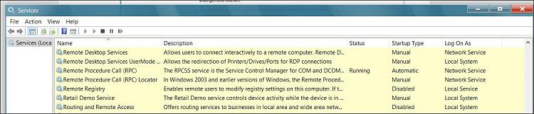

  4. dalchina Win User
    RPC server.
    Credential Manager - 0x800706BA - The RPC server is unavailable
    Hi, please review the state of your services vs this:
    Restore Default Services in Windows 10
    Have you ever changed the state of any of your services, or chosen to disable any?
    RPC: I have
    RPC server. 351597d1637009387t-credential-manager-0x800706ba-rpc-server-unavailable-1.jpg
    I can confirm my Credential Manager starts.
    Observing the cautious preparatory steps prompted by this free tool:
    RPC server. 351598d1637009555t-credential-manager-0x800706ba-rpc-server-unavailable-1.jpg
    you might try only selected repairs- there are at least two service- related repairs available.
    Firewalls and ports:
    You mention firewalls. Are you using any security software besides Windows Defender?
    You've probably seen:
    Troubleshooting 'RPC server unavailable' 0x800706BA - [SOLVED] enterprise IT
    dalchina, Jan 15, 2023
