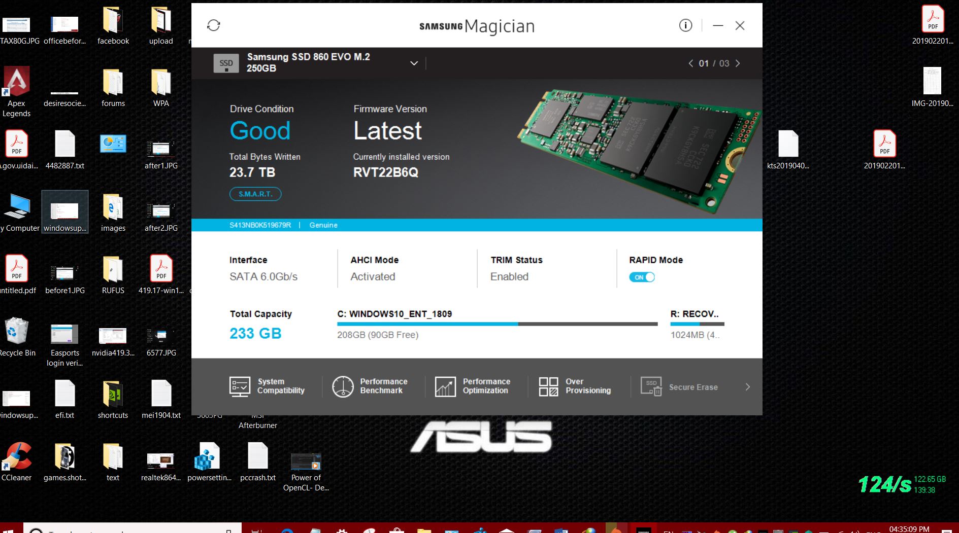

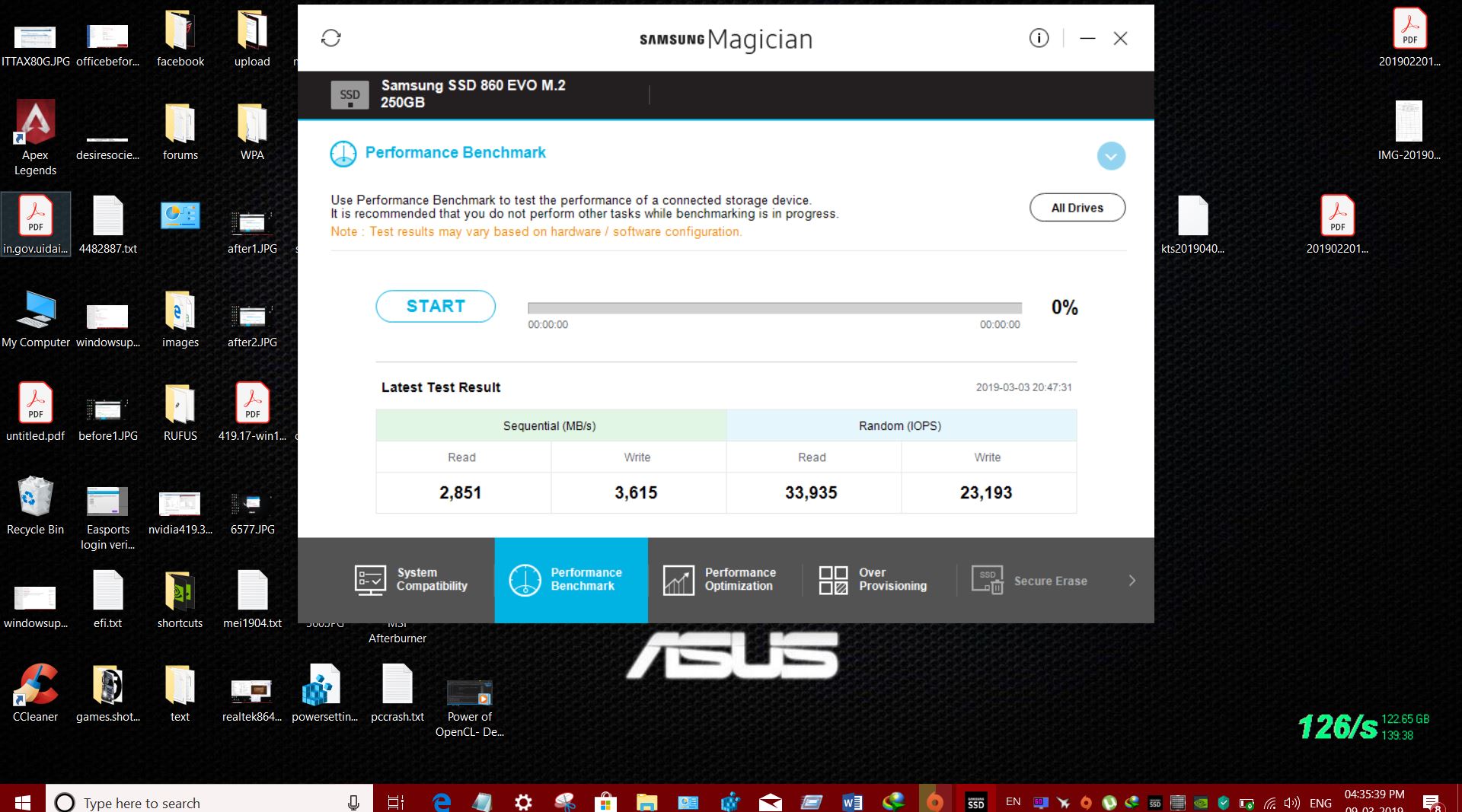

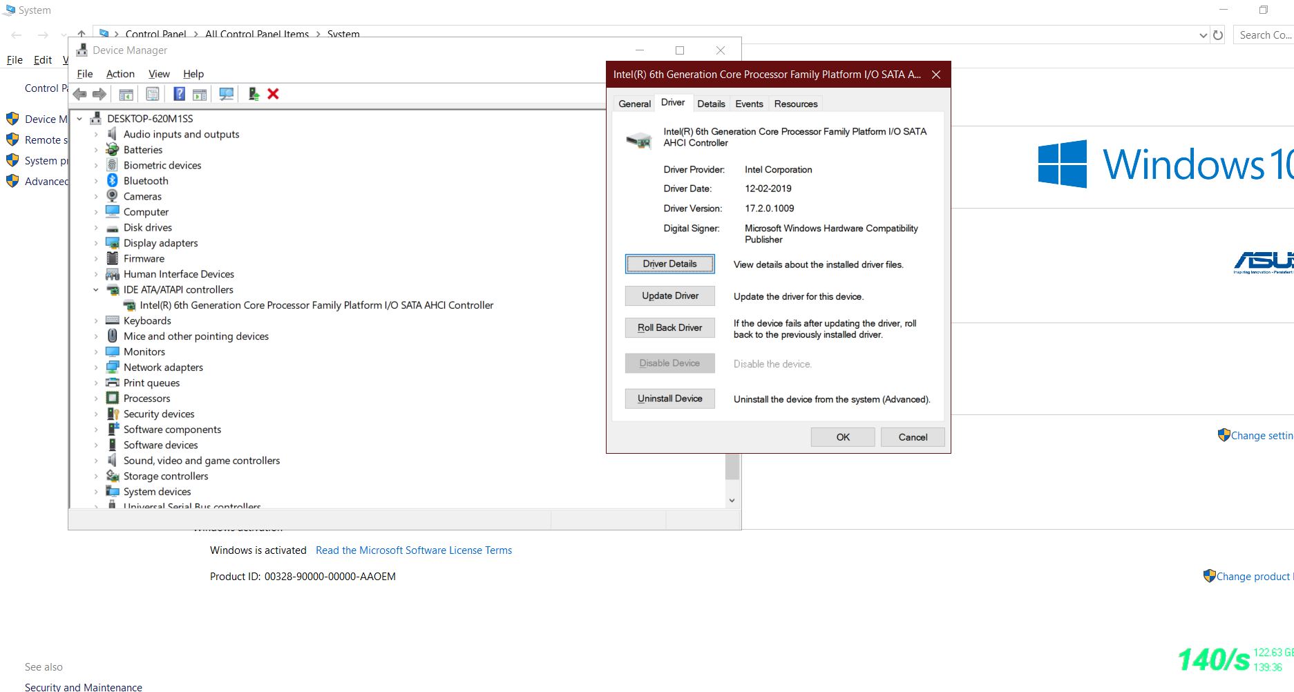

  4. Gary Win User
    Samsung EVO 850 SSD no longer working after WIN10 1809 upgrade
    Samsung SSD 850 EVO
    Samsung EVO 850 SSD no longer working after WIN10 1809 upgrade [​IMG]
    Gary, Mar 9, 2019
  5. i seen thepicture , thats a microsoft driver ,. But you must install the achi driver , you can download from intel . Intel released latest RST driver which contains latest ACHI driver.
    I have generic achi driver from intel but it modified by unknown genious person , i downloaded from other site and then i installed through device manger
    RAJU.MSC.MATHEMATICS, Mar 9, 2019
