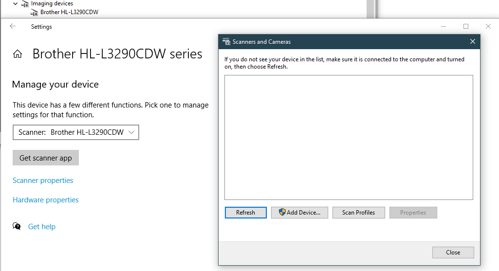

    I have a scanner that I can connect to either via USB or Wi-Fi networking. On my laptop via Wi-Fi it works as printer and scanner. On my desktop via USB or Wi-Fi it shows up as both but only works as printer. It never shows up to do scans with. I have tried tools like Paint.Net or Brother's tools and neither works. I can't figure out why it seems to be there but not functional?
    Scanner shows as installed but not available to scan? ad2b5bef-615c-4912-a68f-5368995b62c3?upload=true.png
    It shows in Device Manager under Imaging Devices and in Settings under scanner but it you bring up Scanners and Cameras it doesn't show up.
