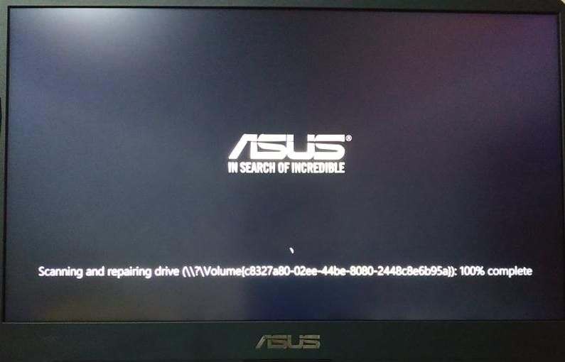

  1. scanning and repairing drive volume during windows 10 installation ?
    This message appear when first reboot, second reboot and last reboot " scanning and repairing drive volume (name and number) and percentage. Windows just installed successfully. But i curious what is this and is it fine?
    This is the screenshots
    scanning and repairing drive volume during windows 10 installation ? cE5rQso.jpg
    mikelferdinan, Aug 26, 2019

  3. Xylee Del Win User
    Scanning and repairing drive (Cscanning and repairing drive volume during windows 10 installation ? :) Windows 10
    Windows 10 may have encountered a system file corruption after it was turned off while it was scanning and repairing drive (Cscanning and repairing drive volume during windows 10 installation ? :). For us to help you access your computer and end the scanning and repairing loop, we suggest that you perform a startup repair.
    Kindly follow the steps below:
    • Start your computer from the installation media, Insert the DVD or USB flash drive and restart your computer. Press a key once you see a message that says
      Press any key to boot from DVD.
    • On Install the Windows screen, select Repair your computer to the
      Windows Recovery Environment.
    • On the Windows Recovery Environment, on the Choose an option screen, select
      Troubleshoot
    • Select Advanced options. Under Advanced options, select
      Startup Repair.
    • Startup Repair will now start Diagnosing your PC, and will perform an automatic repair.
    Meanwhile, if you don't have a disk or USB, download the ISO from a different computer and try creating a bootable disk or USB. Kindly refer to this
    link
    and follow the second option that says Using the tool to create installation media to install Windows 10 on a
    different PC.
    Please get back to us with the results.
    Xylee Del, Aug 26, 2019
