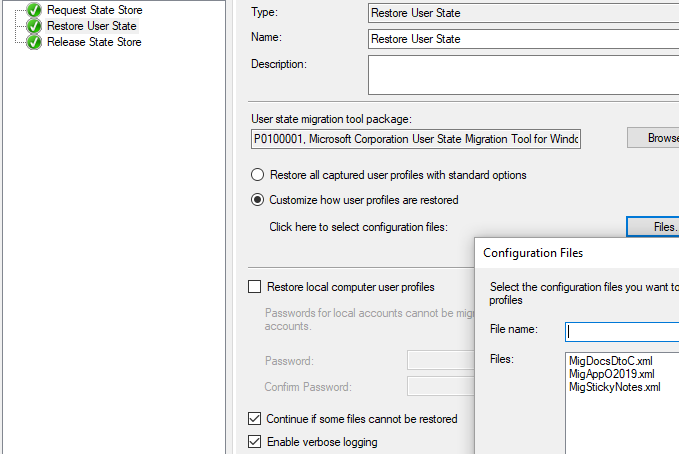

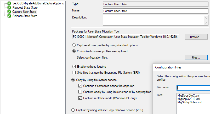

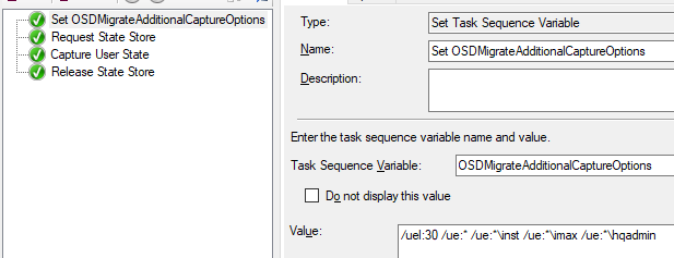

    I do the migration of W7 to W10. On W7, the user profiles are on the D Drive and on W10 on the %systemdrive%
    I will use the MigDoc.xml and MigApps.xml. The MigApps is coming from the Ehler custom xml.
    So... Here my questions...
    Could you please tell or correct me what steps I need to put in a TS with SCCM 1806 to have the process working with USMT ?
    And important, how to change the xml to save (capture) the data's from D drive (W7) and restore (load) to the C drive (W10) ?
    So from my Full TS, I add a TS USMT Backup a first step in WinPE and the last step a TS USMT Restore.
