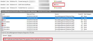

Windows 10: SCEP deployment to Windows 10 devices fails after you renew the CA certificate
Discus and support SCEP deployment to Windows 10 devices fails after you renew the CA certificate in Windows 10 News to solve the problem; [ATTACH]SCEP or Simple Certificate Enrollment Protocol, is a protocol that allows devices to enroll for a certificate using a URL and a secret key. On... Discussion in 'Windows 10 News' started by WinClub, Sep 6, 2020.
