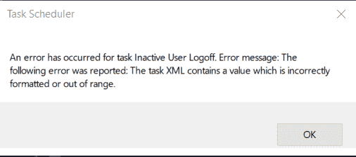

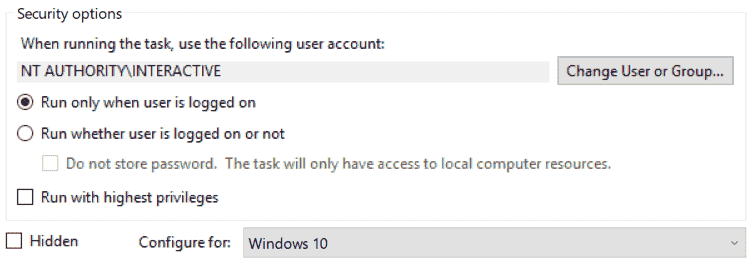

    I am receiving the following error when I modify a scheduled task and try to save it.
    "The task XML contains a value which is incorrectly formatted or out of range."
    This reliably occurs when I change the Runas user account for the schedule task to "NT AUTHORITY\INTERACTIVE".
    Scheduled Tasks - The task XML contains a value which is incorrectly formatted or out of range. a5877254-3c8a-4650-bd16-997784a97df8?upload=true.png
    When I click "Ok" I get the following:
    Scheduled Tasks - The task XML contains a value which is incorrectly formatted or out of range. 7f52e55c-4dd4-498c-a2df-80474a8eecd2?upload=true.png
    If I change it to my username it works fine. I do not receive this error. I can use "NT AUTHORITY\SYSTEM" account and that works fine as well, but it forces me to to "Run whether user is logged on or not" and I need this task to run under the currently logged in user account which is why I am trying to us "NT AUTHORITY\INTERACTIVE".
