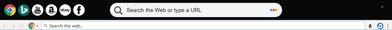

    Search Bar on top of screen
    How do I remove this search bar that's stuck on top of my screen?

  2. Downloaded app, and a random search bar came to the top of my screen.
    The search bar that is showing on the upper part of the screen is a 3rd party search bar tool. This tool bar may have been included during the installation or when you installed the CamStudio on your computer. To take that off from your screen, we suggest
    that you uninstall the search bar tool. To do that, follow these steps:
    • Right-click on Start and click Control Panel.
    • Go to Programs and features and click Uninstall a Program.
    • Under Uninstall or change a program, scroll through the list to check if there is any third party tool\search bar installed on the computer.
    • If yes, right-click on the tool\search bar and uninstall it.
    Reply to the post with an updated status of the issue so that we can assist you further.
    Marque Lor, Feb 20, 2020
  3. DaveM121 Win User
    search bar at the top of my screen
    Hi Kathy
    Do you have a web search bar stick to the top of your Desktop, that stays on top of everything?
    If so it is one of 2 search bars, the usual culprit is Web Bar, but that may lao be a Google search bar . .
    Press Ctrl + Shift + Esc to open Task Manager
    Scroll down to find Wb. exe - on the right it should say Web Bar in the Description - if you don't find that also look for a google bar
    Right click that and choose 'End Task'
    Does that get rid of this annoyance?
    If so, go to Control Panel - Programs and Features
    Scroll to the bottom of the list of installed Apps, then find and Uninstall Web Bar
    DaveM121, Feb 20, 2020
  4. Search Bar on top of screen
    edge search bar at the top of the screen
    - May occur if a third party search\tool bar is installed on the computer.
    I suggest you to go to Programs and Feature and check if there is any third party tool\search bar installed on the computer. If yes, uninstall it and check if it helps.
    a) Right-click on Start and click on Control Panel.
    b) Click on Programs and features and click on Uninstall a Program.
    c) Under Uninstall or change a program, scrollthrough the list to check if there is any third party tool\search bar installed on the computer
    e) If yes, right-clickonthe tool\search bar and uninstall it.
    Hope this information helps.
    MilagrosM2020, Feb 20, 2020
