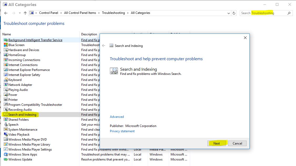

    There could be a possibility of a corruption in search and indexing. It's also possible that the indexing was not completed yet that's why it's not showing the missing files. To isolate your concern, we'd like to ask the following:
    • When you mentioned D Drive, are you pertaining to a partition or a separate external drive?
    • Were you able to check if indexing was already completed?
    In the meantime, we suggest that you run the Search and Indexing troubleshooter and check if it helps to sort out the issue. Go to Control Panel. In the search box, type
    troubleshooter, and then click Troubleshooting. Click
    View all, and then select Search and Indexing. Follow the onscreen instructions to run the troubleshooter.
    Search indexer forgets files on my second (internal) drive ba52b872-de17-476e-87e9-f4e053cd96bd?upload=true.jpg
    For any results, just send us a reply.
