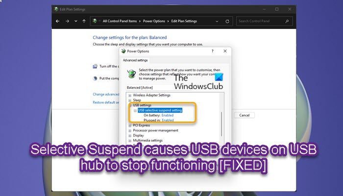

    Selective Suspend causes USB devices on USB hub to stop functioning Selective-Suspend-causes-USB-devices-on-USB-hub-to-stop-functioning.jpg ​
    You may notice USB devices may stop functioning correctly when multiple devices connected to the same USB hub go into selective suspend. In this post, we will identify the root cause of the issue, as well as provide the most suitable solutions to resolve the issue on your Windows 11 or Windows 10 computer. When […]

  2. USB HUB
    Incompatible USB hub driver is one of the possible reasons why this issue is happening. We recommend uninstalling the USB Root Hub driver and see if it helps. Follow the stepes below:
    • Open Device Manager.
    • Double-click Universal Serial Bus controllers to expand.
    • Right-click USB Root Hub, then click Properties.
    • Go to the Driver tab.
    • Click Uninstall.
    • Restart your computer.
    Note: Restarting your computer will automatically reinstall a generic driver for your computer. Also, we suggest connecting your USB hub while performing the steps.
    If the issue still persists, let's disable the USB selective suspend settings thru Power Options to resolve the issue. Follow the steps below:
    • Type Power Options in the search box, then press Enter.
    • Locate USB settings > USB selective suspend settings.
    • Select Disable.
    Keep us in the loop with the result.

  3. Unable to disable USB Selective Suspend
    Try this:
    Go into your device manager and under Universal Serial Bus Controllers. Under there you will see USB hubs. In the properties for these hubs you will see a power management tab. Go under that tab and uncheck the option that allows the computer to turn the hubs off.
