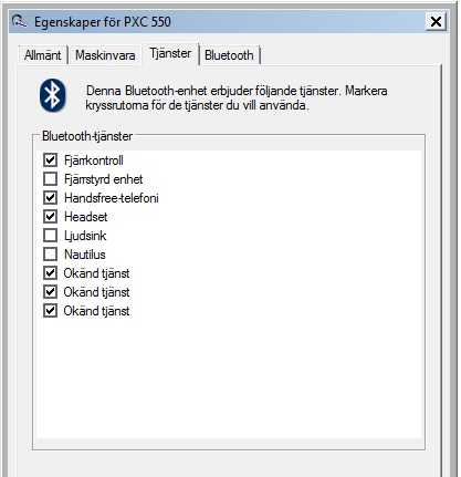

  4. GurraP69 Win User
    Sennheiser PXC 550 Pairing and connecting but being installed as unspecified device and not...
    Sennheiser PXC 550 Pairing and connecting but being installed as unspecified device and not playing back anything from computer.
    • Start Device Manager
    • Right-click PXC 550 and select Properties
    • Choose the tab Services
    • Check the ones you need
    Sennheiser PXC 550 Pairing and connecting but being installed as unspecified device and not... 8809239e-cbf8-4017-8da5-475ad75c8c5b.jpg
    GurraP69, Jul 10, 2019
