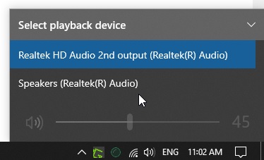

    Hello!
    So here is my problem. On my computer i have always a headset plugged, and also speakers at the same time. I usually switch the output i want using the sound icon on my taskbar, like that :
    Set "Default communication device" at the same time as "Default device" from the task bar 62d39f46-3594-47d6-90c2-96d79547a578?upload=true.jpg
    The problem is that this changes my sound output "Default device", but will not change "Default communication device". Applications like Discord, teamspeak, skype etc... all use the "Default communication device" to choose where to output the sound. This is really annoying because each time i change from my speakers to my headphones I do it several times each day, i have to go change the output from windows then also in the application im using. otherwise the sound outputs from the wrong device.
    Is there any way to fix that? Im thinking about a few ways i could solve that :
    - Disable completely the "Default communication device" or merge the 2 default, to have only 1 default. I don't even understand why i would need 2 different default devices...
    - When i change the output using the "Select playback device" it changes both default at the same time.- Make apps like discord use the "Default device" and not the "Default communication device", but i don't see any options for that.
    Any ideas ?
    BobbyWhiskey, May 30, 2020
