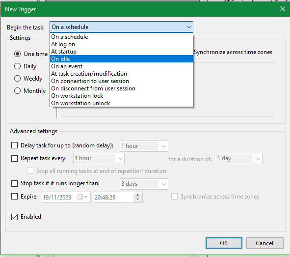

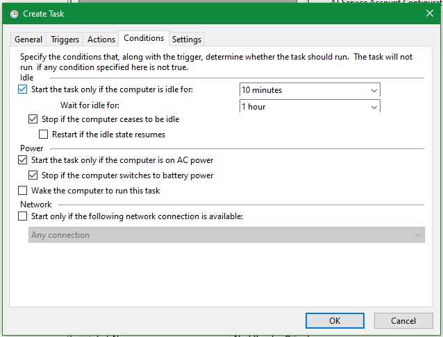

    Both triggering when idle & stopping if idle stops are options written into Task scheduler task definitions. What's stopping you choosing them?
    Setting up an Idle Restart Task 379518d1668891041t-schedule-task-idle-trigger-idle.png
    Setting up an Idle Restart Task 379519d1668891056t-schedule-task-idle-stop-when-idle-stops.png
    Task scheduler is often awkward and you might find useful guidance in previous TenForums threads that report the experiences of others when setting up an idle task. https://www.tenforums.com/search.php?query= These are the only idle-related ones I kept links to Task Scheduler - On Idle does not wait - TenForums Idle and the effect of rebooting - SevenForums Task Idle Conditions [WinServer] - MSLearn TaskScheduler - Task Idle Conditions - ServerFault on idle problems and a retracted explanation - EightForums What is Wait for idle for - Super User All the best, Denis
