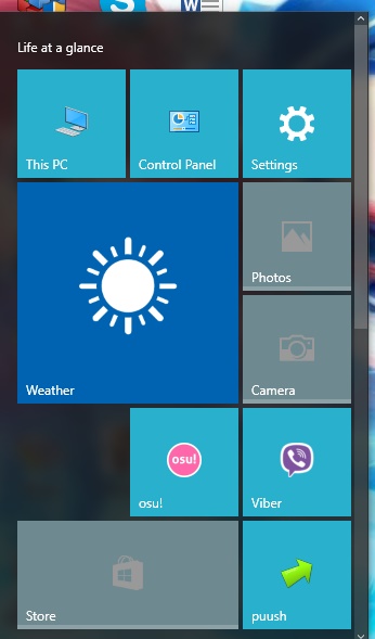

    I recently did a system restore on windows 10 and all my metro apps were renamed to something like this: microsoft.windowscommunicationsapps_8wekyb3d8bbwe so I decided to reinstall windows 10 by going back to windows 8.1 and reinstalling.
    After reinstalling, my metro apps are grayed out when pinned and it instantly crashes when I try to launch. Windows store doesn't work either.
    Settings Metro App - Instantly Closes - Cant Diagnose The Issue. acaa0dfb-4290-461d-b7d8-0583b0131186.jpg
    Please help !!!
    UPDATE: When I try to open a file with a metro app for eg. photos, it says 'The application cannot be started because it is currently updating.' When I create a new user, windows store and the metro apps works fine.
