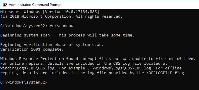

    When I run SFC scan , cmd displays that corrupt files are found but was unable to fix some of them.
    Here is the screen shoot :
    What should I do ?

  2. PaulPChou Win User
    SFC scan and DISM restorehealth scan
    1. After the sfc scan, restart
    2. Run the restorehealth scan and restart after the scan is finished
    3. Run the sfc scan again and it will say: no integrated violations found
    Does those steps fix the Windows Resource Protection found corrupt files but was unable to fix some of them?

  3. PaulPChou Win User
    I want clarification about the SFC scan. When it states: no integrated violations found, that means I do not have to worry about anything, right? My device is issue free? I did the sfc scan this week and it has replaced corrupted files. I contacted the Answer
    Desk and ask how to have it say: no integrated violations found, an agent gave me the troubleshooting steps below.
    I went to 1709 last year via the in-place upgrade but went back to 1703 because
    Windows Resource Protection found corrupt files but was unable to fix some of them. 1703 didn't have that issue at that time. My question is: Will the three steps fix
    Windows Resource Protection found corrupt files but was unable to fix some of them? I mean will it say: no integrated violations found by performing the three steps?
    I found on support site to manually replace them, which I do not know how to do.
    I am going to clean install my device to 1709.
    PaulPChou, Sep 30, 2019
