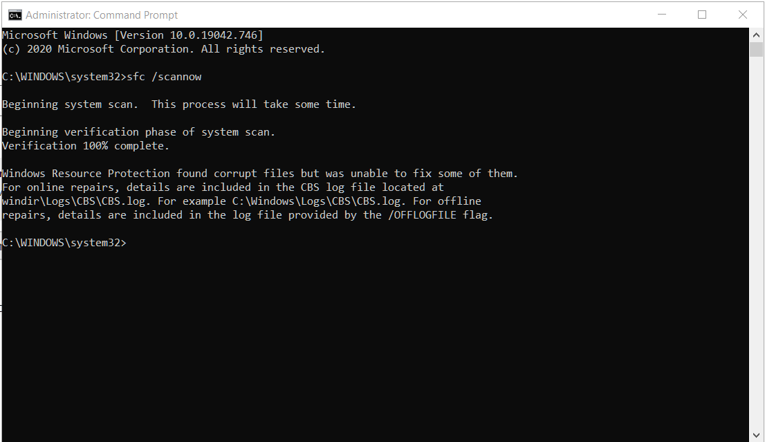

    Hi guys,
    when i task my pc with sfc /scannow, it fails. Below is a screenshot of it.
    SFC / SCANNOW failing. a3bc2a97-3ce8-459d-915f-64761214d545?upload=true.png

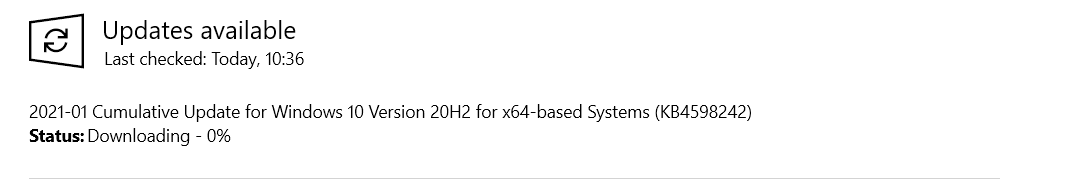

    I am also unable to install one of the new windows updates as it keeps failing. it is this one.
    SFC / SCANNOW failing. 359855af-f176-40f0-b3d6-d1ecfdd074ac?upload=true.png

    We appreciate the efforts you have taken in trying to resolve this issue. I have analyzed the error logs that you have shared and I would suggest you follow the steps mentioned below:
    1. Type Command Prompt in the
      search bar
      on the Taskbar.
    2. Right click on the Command Prompt icon and select
      Run as administrator.
    3. Now, paste the following command and hit Enter:
      DISM.exe /Online /Cleanup-image /Restorehealth
    4. Once the DISM command is executed, we would suggest you to run sfc /scannow again.
    If the integrity violations are not repaired after running sfc scan, the best option will be performing a repair installation. A repair installation will repair all the corrupted files.
