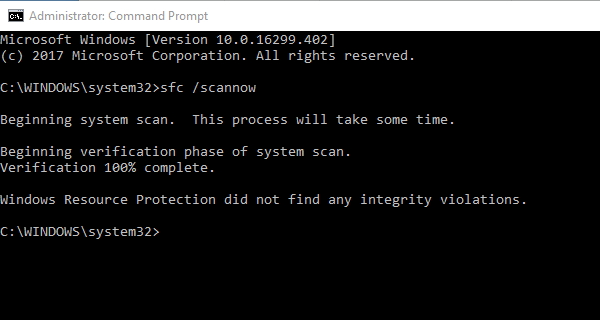

  3. davidhk Win User
    Sfc /scannow..... found corrupt files but unable to fix some of them.
    Final solution........ did a Repair Install. That fixes the sfc issue.
    sfc /scannow found corrupt files but was unable to fix some of them 186500d1524977348t-sfc-scannow-found-corrupt-files-but-unable-fix-some-them-sfc.jpg
    davidhk, Dec 20, 2023
