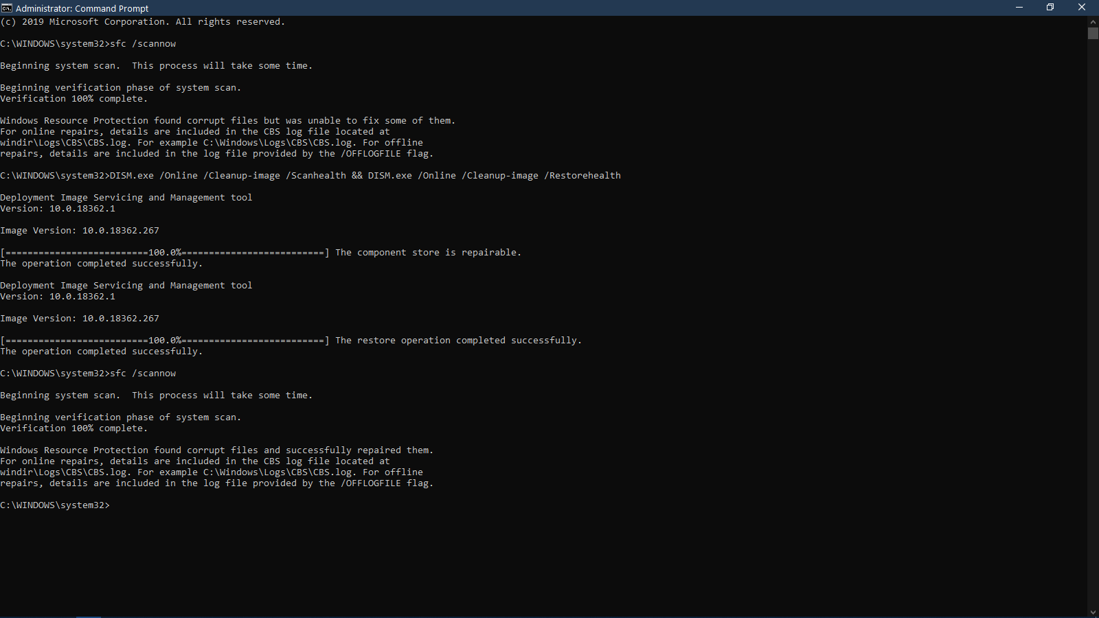

    This is a question I have seen asked more than once. The answer, of course, is to run DISM. And THEN to run SFC /SCANNOW again.
    This is my session from last evening which is what reminded me that I keep seeing this question.
    SFC /SCANNOW says it found problems and couldn't fix them....NOW WHAT? 53ac6fb6-f1f7-4fc3-a0c6-e847c1f4bb67?upload=true.png
    Now, as you can see, I did exactly what I SAID should be done until all the problems were repaired. Then I stopped and went back to enjoying my computer.

    sfc /scannow says this.
    Well, I think we don¡t need the log, hahaha. The sfc report says everything is good now:
    SFC /SCANNOW says it found problems and couldn't fix them....NOW WHAT? [​IMG]
    I guess the DISM thing solved it? It's a mistery to me.

    That's why Im asking the question. Am I correct in thinking that its perfectly normal that after the second running of sfc /scannow in your list you would get :-
    Beginning system scan. This process will take some time.
    Beginning verification phase of system scan.
    Verification 100% complete.
    Windows Resource Protection found corrupt files and successfully repaired them.
    For online repairs, details are included in the CBS log file located at
    windir\Logs\CBS\CBS.log. For example C:\Windows\Logs\CBS\CBS.log. For offline
    repairs, details are included in the log file provided by the /OFFLOGFILE flag.
    Then after that..its the third sfc /scannow that you list that comes up clean .
    Ivghandi was saying that he presumed that the second sfc /scannow you list showing "Windows Resource Protection found corrupt files and successfully repaired them" meant that he still had a problem.
    The way I understand that DISM works is that it repairs the Component Store. Then when you run SFC /scannow again it can then repair the file corruptions it detected originally. Have I got that correct?
