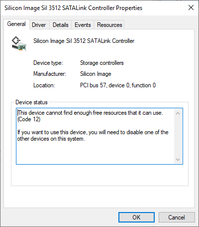

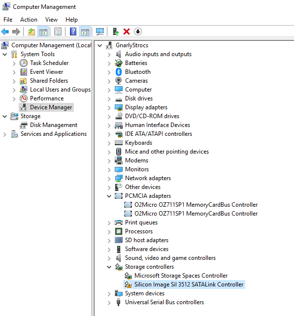

    I have a Silicon Image SiI 3512 PCMCIA card I would like to use with an older laptop, a Fujitsu Lifebook T1010. Windows reports the PCMCIA controller itself is just fine, but reports a code 12 cannot find enough free resources for the SiI card. See the below screen caps for the SiI 3512 card and Device Manager overall PCMCIA controller expanded, showing healthy.
    Silicon Image PCMCIA card reports code 12 cannot find enough free resources in Windows 10 81c5ef28-3c04-4346-987f-335d16726d24?upload=true.png
    Silicon Image PCMCIA card reports code 12 cannot find enough free resources in Windows 10 1cc13d2a-0ad5-4b33-8f98-296420eb5c75?upload=true.png
    As you can see, the SiI 3512 card the PCMCIA card is showing a code 12 not enough free resources. I've tried using older versions of the SiI driver, but the result is always the same -- code 12. I have Silicon Image SATA controllers in other computers running Windows 10 or Windows Server 2019 and they work fine, although none of these are PCMCIA cards. They're all PCIe. In any event, that seems to rule out a driver versioning issue.
    The driver file shown for the O2Micro OZ711SP1 MemoryCardBus Controller is C:\Windows\system32\drivers\pcmcia.sys.
