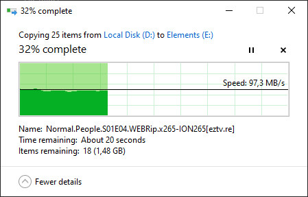

  4. # Anakin Win User
    Slow transfer speeds to USB on Windows 10
    Slow speed transfer USB 3.0 on Windows 10
    I have a Lenovo IdeaPad 3 15ALC6 laptop but right now I'm facing a issue with Windows 10.
    When I try to transfer files to my external drive (which is a WD Elements 2TB) using the USB 3.0 port, i only get about 87MB/s to 104MB/s at maximum speed transfer. It turns out I have Ubuntu 22.04 dual booted on the same laptop so my first thought was to test the drive on this OS.
    I used the same USB port and tried to transfer the same file to the same external drive and for my surprise speed transfer was about 320 ~ 372MB/s on Ubuntu. So it's not a problem with the external drive nor the USB Port itself, i guess.
    I already did some research, but none of the things people told others to do fixed my problem.
    What I already did:
    • Check for USB drivers updates
    • Uninstall then reinstall USB Serial Bus Controllers
    • Check for firmware updates for my external drive
    • Check for BIOS updates
    • Check if USB 3.0 is enable
    • Change USB removal policy to "Better performance"
    I don't know what else to do, any help? Windows 10 is basically slowing down by more than half all my USB 3.0 speed transfers.
    Windows version: 22H2 OS Build19045.3570
    Slow transfer speeds to USB on Windows 10 0Tc5MmTroVa66CTrNAOJRzaHIIzgmFD3KUjNcdyC3QaO2q%2f%2bzJg3whBngpfOp1U9oAySNpowim2edZmh0LdupkEYQ%3d.png
    # Anakin, Nov 21, 2023
