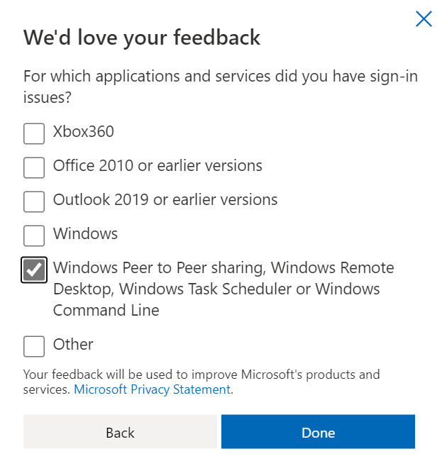

  4. WonChang Win User
    SMB folder sharing after going passwordless with the microsoft account
    Signed in Windows 11 with passwordless account. What is the credential info of folder sharing?
    SMB folder sharing after going passwordless with the microsoft account dc1955d5-e6c1-4dfa-8dea-86e76fd0240a?upload=true.png
    Microsoft dev team is already aware of it. Problem solved by turning off the passwordless account to use sharing and remote desktop.
    WonChang, Jul 23, 2022
