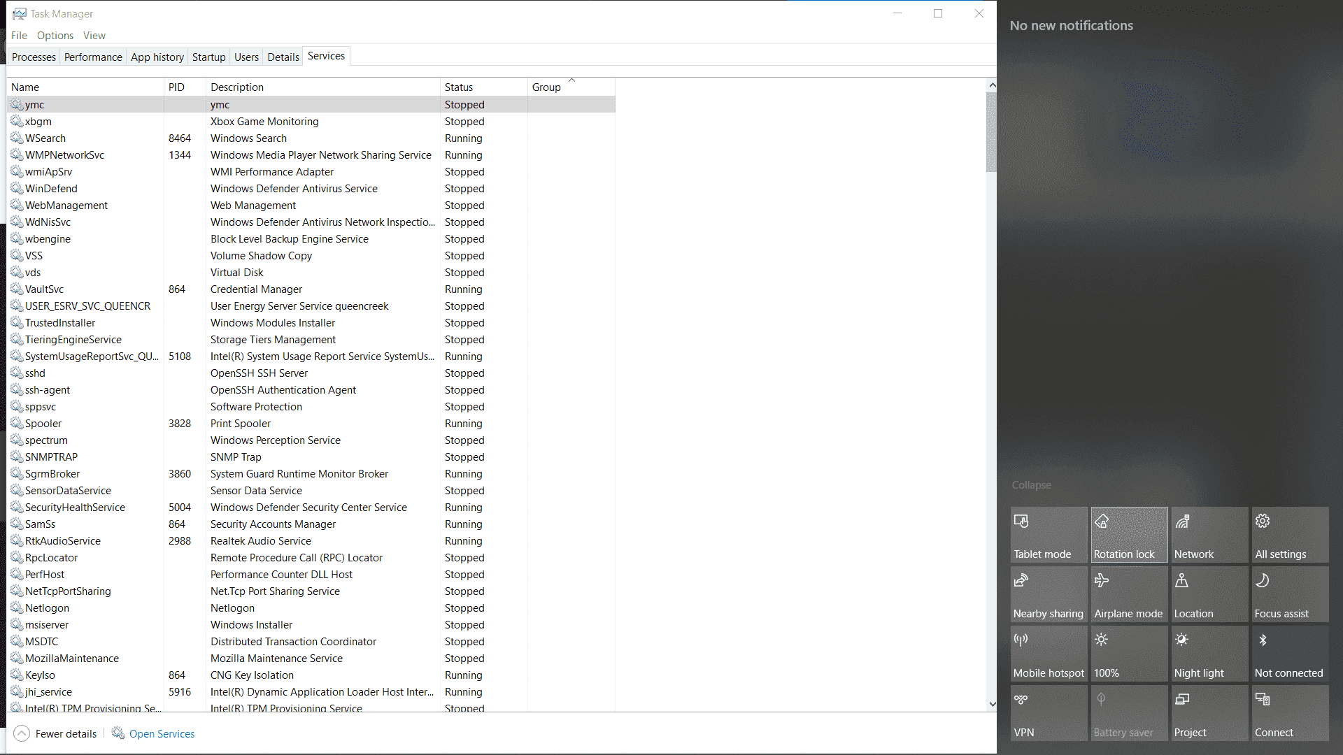

    Hi i wanted to share my discovery of why all Windows 10 lenovo Yoga touchscreen laptops have the rotation lock grayed out sometimes and cannot reactivate;
    if your rotation lock button in action center is grayed out like this
    So what's the answer, my lenovo voga 720 has grayed out the rotation lock!!! Help Mr. Wizard. fd9f63b3-1f59-4e13-94ab-c19fb5b6eb0b?upload=true.png
    Go to Task Manager (press ctrl + alt + delete), and click on the services tab, and look for
    ymc process (ymc.exe = Yoga Mode Control, which is the culprit, and it happens when you rotate your screen to portrait mode)
    So what's the answer, my lenovo voga 720 has grayed out the rotation lock!!! Help Mr. Wizard. 2793e16c-0a1b-4515-a0e7-170de2d61c9e?upload=true.png
    Right click on ymc, and stop the process. Leave it that way. Your Rotation Lock will remain unlocked now. It was a mid-late 2018 update from Lenovo which made this ymc cause the grayed out screen rotation lock. The computer works fine without this process,
    and in fact, it is precisely this process, intended to sense when to change to tablet mode and back to laptop mode when folding the screen, which causes the issue. There will be no adverse effects from deactivating this process. If you deletre it, Lenovo will
    put it in your next update and it will reappear, so best to just 'stop' the process.
    Thailand Amulets, Oct 3, 2018
