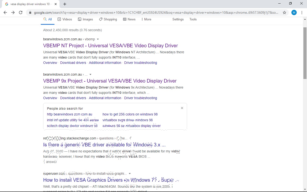

    Not sure what happened but a few months ago probably after an update the screen starts to randomly get garbled. it is a software issue as you can see from this screen shot, if it was the display itself windows wouldn't have copied it in the saved image Intel G45/G43 Express wddm 1.1
    any thoughts on a solution? Tried generic driver but it doesn't detect a reasonable resolution for the LCD. 800/600 or 1024/768 instead of 1440/900
