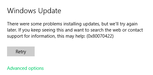

    A common place for the update error to be displayed is when you open the update settings and run a check for updates, have a check run automatically by the operating system, or when the system attempts to install updates.
    Windows may return the following information for that error:
    There were some problems installing updates, but we'll try again later. If you keep seeing this and want to search the web or contact support for information, this may help: (0x80070422)
    You may select retry, but the error will not go away when you do. The Internet is filled with blog posts and articles that claim to have a solution for the issue. Many use these post to sell troubleshooting software or backup applications, some provide solutions, but often using complicated instructions and walls of text.

    The explanation that Microsoft provides in its error message is not really helpful. While it does state that there "were some problems installing updates", it does not provide a solution, other than "try again later". Usually, this will not resolve the issue.
    It is clear that the error is related to updating, as it is thrown during update checks or installations. The main cause for error code 0x80070422 is that the main Windows Updates service is not running on the device, and does not start when it is required.

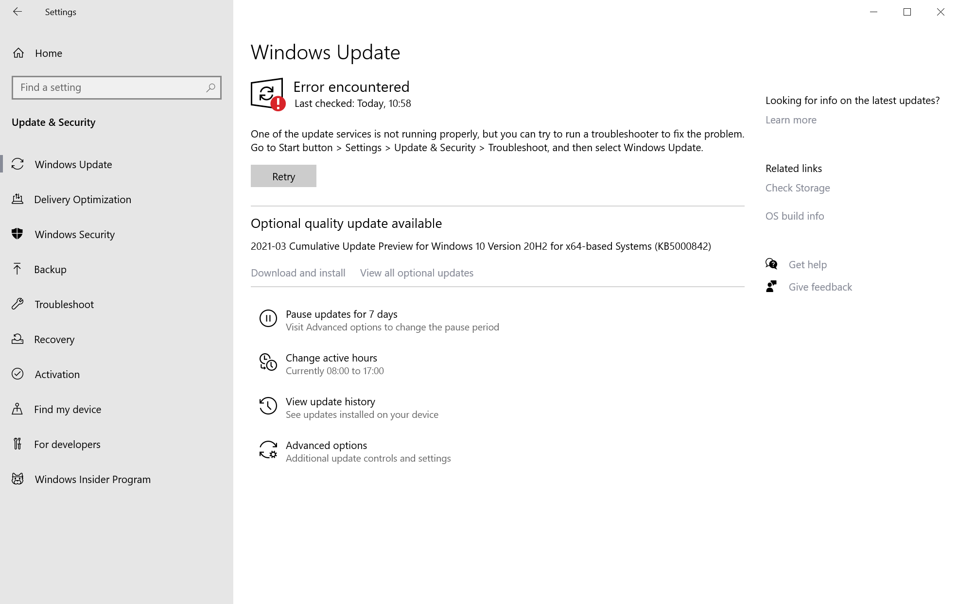

    Note: in newer versions of Windows, you may get a different and better error message. It states:
    One of the update services is not running properly, but you can try to run a troubleshooter to fix the problem. Go to Start button > Settings > Update & Security > Troubleshoot, and then select Windows Update.
    Running the Windows update troubleshooter will fix the issue in most cases, as it will reset Windows Update services to ensure that the service runs properly on the device.
    A likely explanation for the two errors that users may get is that the "old" error code is shown in earlier versions of Windows 10 (and previous systems), and that the newer optimized description is displayed in newer versions. It is just an assumption though, as Microsoft has not published anything about this.

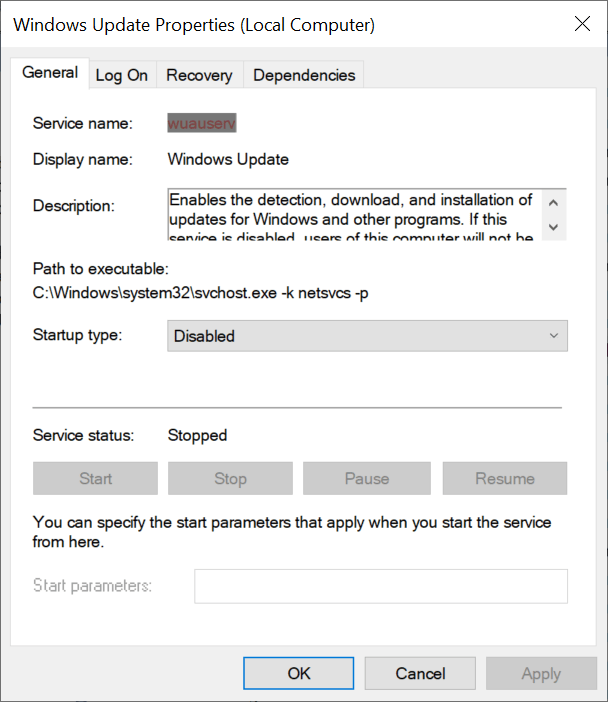

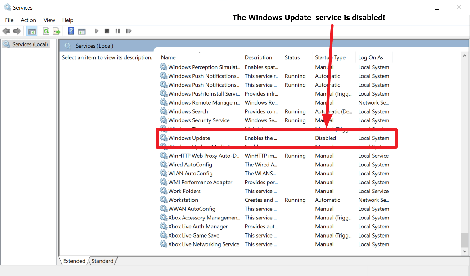

    You may run the troubleshooter as explained in the section above to fix the issue. Or, you can fix it manually by following these simple steps:
    1. Activate the Start button to display the start menu.
    2. Type services.msc and load the result.
    3. Scroll down in the window that opens until you find the Windows Update service.
    4. Right-click on Windows Update and select Properties.

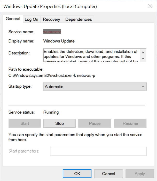

    5. Set the Startup Type to Automatic.
    6. Select OK.
    7. Right-click on Windows Update and select Start.
    The following two screenshots highlight the changes that you need to make:
    Windows Update Disabled
    Solution: how to fix the Windows Update 0x80070422 error windows-update-disabled-service.png
    The correct Update setting
    Solution: how to fix the Windows Update 0x80070422 error windows-update-automatic-1.png
    When you run a check for updates after you have started the service, updating should work fine and updates should be found and installed on the device just like before. If the manual approach is not working, you may want to run the Windows Update troubleshooter to find out if it can correct the issue on the Windows device.

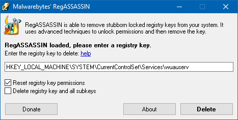

    If you receive Access Denied error when running the above command, try resetting the Windows Update service registry key permissions to default.
    Download RegASSASSIN from Malwarebytes and run it.
    Input the following registry key:
    In RegASSASSIN, don't forget to UNCHECK the Delete registry key and all subkeys checkbox before clicking on the Delete button.
    You can use RegASSASSIN utility from Malwarebytes to reset the registry permissions for this key: HKEY_LOCAL_MACHINE\SYSTEM\CurrentControlSet\Services\wuauserv
    Solution: how to fix the Windows Update 0x80070422 error k98of.png
    Now, see if you can change the Windows Update service Startup type using the Services MMC or Command Prompt.
