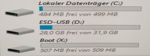

    My UEFI controlled GPT Windows crashed due to tweaking my ram. Windows updates may have occured before that. I don't know.
    The real OS Partition on my ssd is not c: drive anymore. Instead it tries to start win from a 500mb c: partition.
    With a windows usb stick i could not fix the issue.
    But i could take this screenshot after trying to find a driver:
    solved //GPT disk windows 10 tries to load windows from wrong 500mb partion it seems /... 66c15399-a3a7-4baf-8b24-c02a020a5e7d?upload=true.jpg

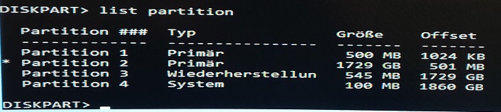

    with diskpart my only m.2 ssd looks like this:
    solved //GPT disk windows 10 tries to load windows from wrong 500mb partion it seems /... 71b3dda9-2f05-4fb9-b85c-7e34d0c8c7b7?upload=true.jpg
    choosing disk 0 reveals:
    solved //GPT disk windows 10 tries to load windows from wrong 500mb partion it seems /... 018f1770-60d1-4093-9064-8aad105fe192?upload=true.jpg
    My issue is that in my Asus/Apex xi/ Bios the ssd will show up only as one entry:
    Windos Boot Manager - samsung evo // and that entry is mapped to the wrong partition i believe
    Somehow C: drive is mapped to partition 1 or 3, instead of my OS on partition 2
    Is this fixable via diskpart ?

    edit: My issue was solved following a YT Video that can be found under "Windows 10 - Repair EFI Partition"
    ThorstenSixt, Oct 18, 2020
