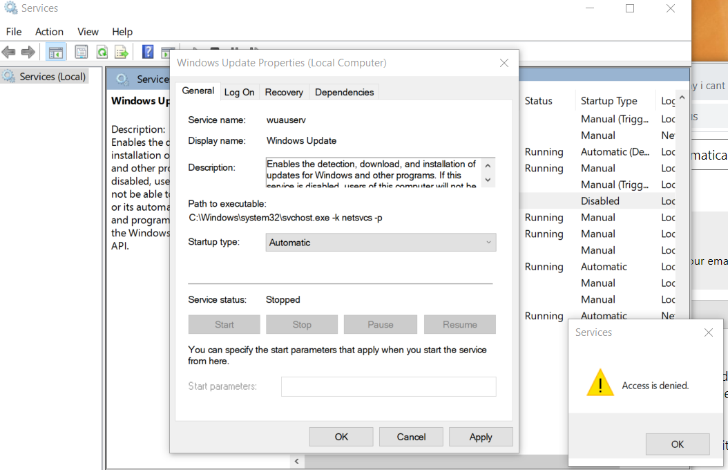

    Hi Guys,
    I'm facing issue when my windows trying to install .net Framework 3.5 and it prompted the error code as per my subject above. I tried to googled the solution and I think the solution should be changing the windows update to "Automatically" on Wndows 10 while mine is shown as "Disabled".
    The problem is when i'm trying to change the startup type to "Automatically" instead of "Disabled" it prompted the error as "Access denied".
    Is there anyone why there is the error prompted out and caused me to fail in changing the startup type for windows update. Please give me a solution if anyone know what is the problem going on.

  2. Windows Store Appps Code: 0x80070422
    Error code 0x80070422 may arise due to corrupted Windows update components. For us to effectively assist you in rectifying this error, we'd like to get the following information:
    • How and when did you encounter the error?
    • Have you made any significant changes to your device prior to this happening?
    • Have you recently installed any updates?
    • Are there any third party applications installed on your computer?
    • What steps have you taken so far to resolve this issue?
    Your response is highly appreciated.

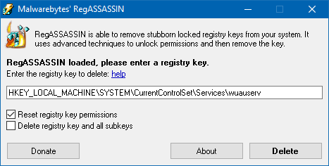

  3. w32sh Win User
    Windows Update Error 0x80070422
    (From: Fix: Windows Update Error 0x80070422 in Windows 10)
    Open admin Command Prompt and execute the following command:
    Restart Windows and see if the Windows Update service starts correctly.
    If you receive Access Denied error when running the above command, try resetting the Windows Update service registry key permissions to default.
    Download RegASSASSIN from Malwarebytes and run it.
    Input the following registry key:
    In RegASSASSIN, don't forget to UNCHECK the Delete registry key and all subkeys checkbox before clicking on the Delete button.
    You can use RegASSASSIN utility from Malwarebytes to reset the registry permissions for this key: HKEY_LOCAL_MACHINE\SYSTEM\CurrentControlSet\Services\wuauserv
    Solving error code: 0x80070422 and Access denied when changing windows update to... k98of.png
    Now, see if you can change the Windows Update service Startup type using the Services MMC or Command Prompt.
    w32sh, Jan 12, 2020
