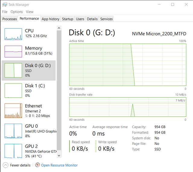

Windows 10: Sometimes SSD will use 100% for a short time. It freezes what it is accessing(like watching...
Discus and support Sometimes SSD will use 100% for a short time. It freezes what it is accessing(like watching... in Windows 10 Ask Insider to solve the problem; [ATTACH] submitted by /u/itsme_shibintmz [link] [comments]... Discussion in 'Windows 10 Ask Insider' started by /u/itsme_shibintmz, May 16, 2022.
  1. Sometimes SSD will use 100% for a short time. It freezes what it is accessing(like watching...
  2. ALuidens Win User
    Windows 10 Freezes; SSD's transfer rate goes to 100%
    I am experiencing the same exact problem.
    • Dell Latitude E5520
    • Windows 10 Version 1607 (OS Build 14393.953)
    • Seagate Momentus XT 500GB (Booting Drive, Disk 0, based on combination 4GB SSD and the rest is HDD).
      • The last few months it was freezing briefly (within a minute or so) and then unfreezes. All activities that do not need to access the drive can be done normally while frozen up to some point.
    • Crucial MX300 SSD 525GB Booting Drive (Disk 0), recently bought to replace the above 'aging' Seagate.
      • Freeze after a few operations and remains frozen until Power Recycled.
      • Disk Active Time spikes to 100% while Disk Transfer Rate is 0 or minimal.
      • All activities that do not need to access the drive can be done normally while frozen up to some point.
    • I have not tried replacing the Microsoft generic SATA driver yet.
    Hope the above helps pin-pointing the issues. I would greatly appreciate assistance in how to replace the SATA driver, if there is no cure from Microsoft yet.
    Thank you in advance!
    UPDATE:
    Applied KB4015438. Same issue:
    UPDATE (03/27/2017):
    Applied KB4016635. Issue persists:
    Replaced Microsoft Generic SATA Driver to OEM (Intel) Driver. System has been stable since 03/26/2017 15:10.
    ALuidens, May 16, 2022
  3. SSD stops and freezes laptop
    Couple of updates:
    1. I created a Linux boot USB key, and monitored my SSD under Linux, so this is evidently not a Windows issue, and
    2. I loaded new firmware for the SSD, and my system seems to be functioning normally now. What a pleasure using a PC that doesn't consistently freeze up.
    Thanks to all y'all for your suggestions!
    Dave
    DavidMiller36415, May 16, 2022
  4. Sometimes SSD will use 100% for a short time. It freezes what it is accessing(like watching...
    Windows 10 Freeze, and SSd usage spiked to 100%
    Hi, after i install a new SSD my pc randomly freeze, when i check in the task manager my ssd usage is 100% but with 0 transfer rate.
    DaraMilford, May 16, 2022
