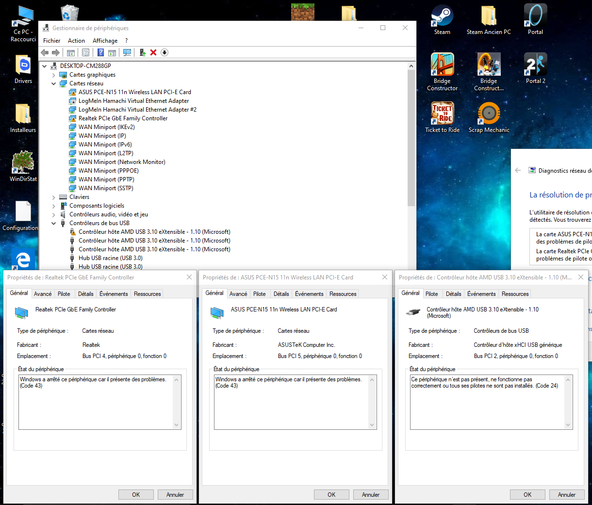

    I post my question here after 2 months of research and attempts to fix the issue.
    Let me first explain in details the problem I'm facing :
    I have got the computer on which I'm facing the issue recently, at the end of August. Very quickly, I've noticed that some parts of the computer would disable randomly. This happens more frequently when Windows and the computer has to manage more tasks (such as when playing a game) but still happens in any case of use.
    By first, sometimes the sound will turn off (this only happens when playing a game. If I close it, it comes back on after playing with the sound cursor.).
    Then, suddenly, all USB ports except 2 (On which I put the keyboard and the mouse) and the Ethernet cable won't be recognized by Windows, and so the connection is cut off, and all plugged devices will be ejected. All USB ports are USB 3.0 or 3.1.
    The only way to fix the issue temporarily is to restart the computer. Sometimes, on the login background, Windows will stop responding for a couple of seconds.
    At some points it always happen, from boot to 2-3 hours later.
    It's important to note that although Windows stops recognizing them, on the back of the PC, the motherboard still indicates that internet is enabled by the cable. The keyboard, which has LEDs, and when plugged to a malfunctioning USB port, continue to be powered, but doesn't perform any action on Windows.
    I didn't found anything in Windows Event indicating an error dated to when it happens.
    When the error has happened, I get the following in the drivers menu :
    Sound, Internet and USB ports randomly stops working (I tried every solution I found) 67186adc-03ef-4485-9605-06856dd4bd00?upload=true.png
    The 2 errors to the left used to happen but now do not anymore. The persistent one is the driver to the very right. It's version is 10.0.18362.207 from June (19) 2019.
